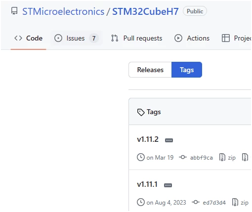

H7 firmware v1.11.2 conflicting types in stm32h7xx_hal_hcd.c and in stm32h7xx_ll_usb.c
I upgraded from v1.11.1 to v1.11.2. Now it won't even compile due to bugs in ST code:

I looked at the code for version v1.11.3 on github and it looks like it is fixed, but that version hasn't been released yet. So when can we expect a fix?

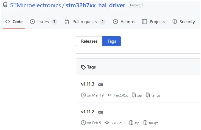

@unsigned_char_array There's mismatch between versions of H7 HAL drivers repo and the "jumbo package".
As you can see on github, the jumbo pack 1.11.2 of Mar, 11 contains HAL drivers 1.11.3
STM32CubeH7 jumbo package 1.11.3 is not available on github yet.
You're not the 1st person confused by this ))

Sometimes the GitHub version is updated before the release on the CubeMX or the ST Website. The Next update will be done on the same time with one of the coming Cube Tools releases. If you find that the GitHub version will solve your issue. You may think about Cloning this GitHub repository and use it for your development.

The github H7 version v1.11.3 was released on 2024-03-19 while STM32CubeMX 6.11.1 was released on 2024-04-25. So why wasn't that version included in that version? When can I expect that release?

Version v1.12.0 of Jumbo pack is now available (1.11.3 was skipped): https://github.com/STMicroelectronics/STM32CubeH7/tags
STM32CubeMX_V6.13.0 is available too.
I've downloaded them. It turns out we made some modifications in the USB library to make it non-blocking and to fix some bugs. Due to updated header files the source files needed to me merged. I added comments in the modified section to make merging easier and then merged them with the new files. Now everything works. It looks like the new USB library has some fixes.
