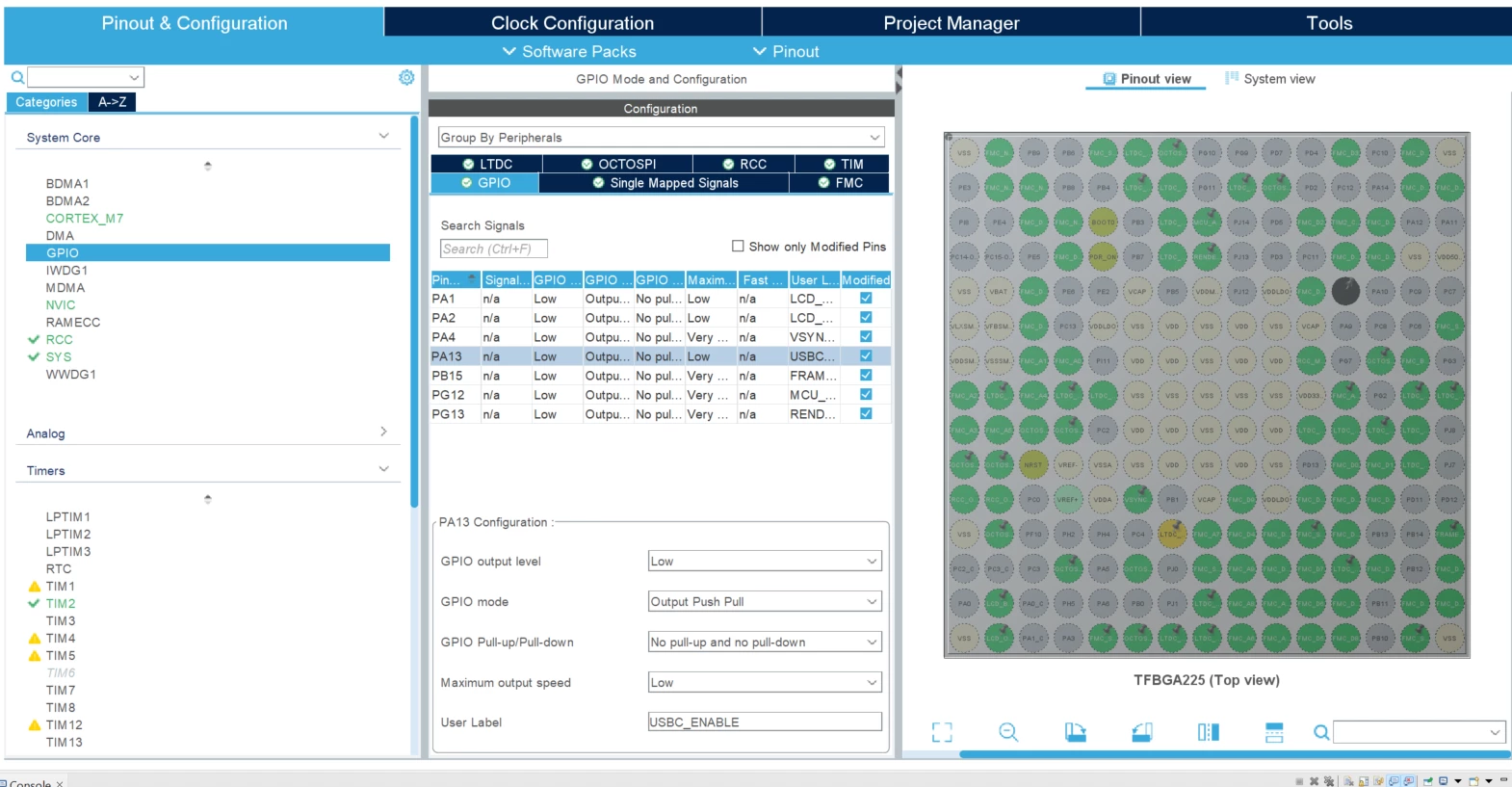

I am trying to understand how to configure a custom GPIO pin via the CubeMX/CubeIDE. I am using the STM32H7B3I-EVAL. Through the CubeMX, I am trying to assign PA13 to a GPIO (in output mode). I enabled PA13 via the CubeMX without issue.

KMew
KMewAuthor
Senior III
November 7, 2022
Hello gbm,
Thank you for the warning. This leads to two follow-up questions:
1) What pins should I use for GP outputs?
2) Once I select the pin, how do I configure and use that pin? There's a command to toggle the pin (Example: HAL_GPIO_TogglePin(GPIOG, GPIO_PIN_13);). How do I know which GPIOx and GPIO_PIN to use?

KMew
KMewAuthor
Senior III
November 7, 2022
Hello gbm,
In the CubeMX view, it has many of hte pins greyed out. That would mean they're not being used, correct? So if I use one of those greyed out pins, it should not affect any other functionality, correct?
Tesla DeLorean
Guru
November 7, 2022
I think it means they are not in use by the peripherals you have currently enabled in the project.
I don't think it means they are not physically committed to some other functionality via the wiring on the board.
Expect close to 98% commitment of all pins to other functionality on the EVAL board.
How egregious those conflicts are depends on what/how those pins are connected too. Have your HW engineer review the board level design.
The EVAL boards are NOT good break-out boards. They are KITCHEN SINK boards where ST has built about every piece of functionality it can demonstrate into a single board. So Screens, SDRAM, Parallel NOR Flash, Serial NOR Flash, Ethernet, Serial, CAN, CAMERA, etc.
