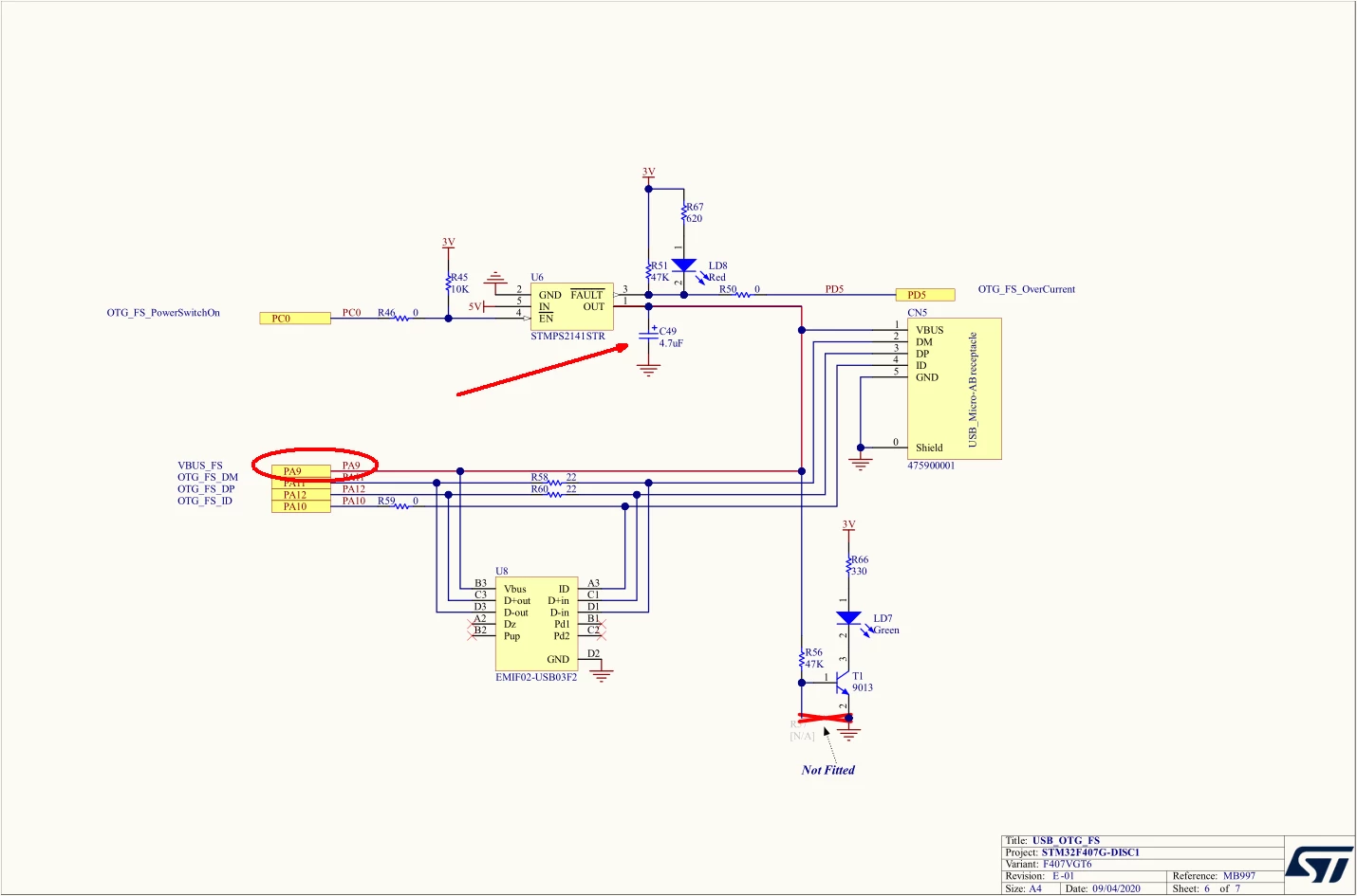

waclawek.jan
Feb 4, 2022 10:15 PM UTC
If a pin on a Disco/Nucleo/Eval does not work as you expect, check the manual/schematics where is that pin connected.
In this particular case, disconnect C49.

Dan in WY
Dan in WYAuthorBest answer
Feb 6, 2022 9:34 AM UTC
I just enabled the 2nd com port and it works fine. I don't think I have the tools to unsolder C49.
