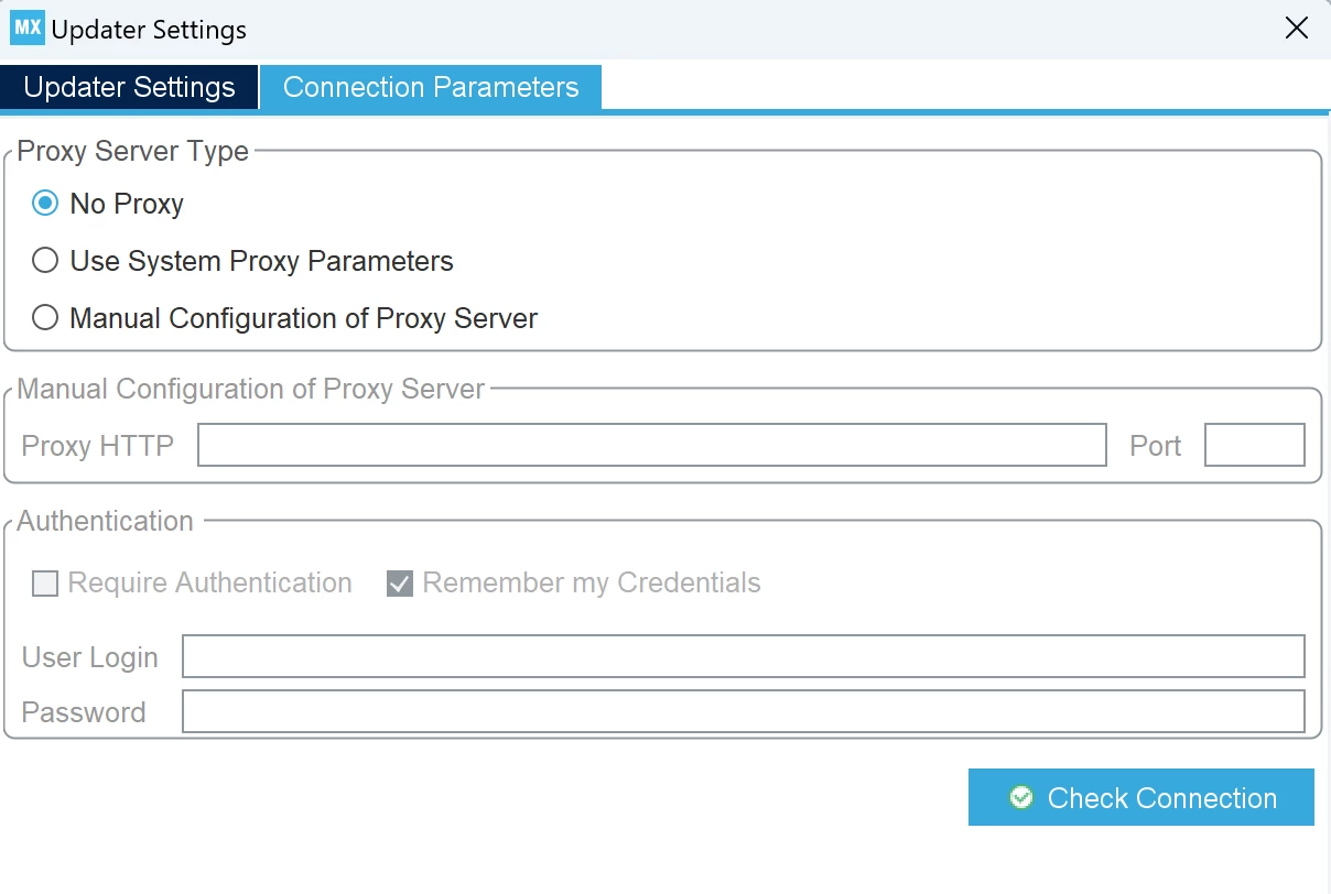

I'm a long time user of Microchip PIC product but since this is my first attempt to use the STM32 I suspect I will have some big time to understand all it's new setup. After looking several video on simple program, I downloaded the CubeMx 6.12.0 and I try those. But as soon as I try to push the blue "generate code" button at top far right, nothing happen. Same thing with the icon on top center "myST" login, nothing happen. I'd like to be able to use the STM32 board for larger and more memory space, so if someone  can help me on this one so I can move on to the programming section, that will be great.

No for MX use no board connection is required, but W7 maybe is issue. ST installs dont right check existence valid library sometimes. Try install more recent VC redist Latest supported Visual C++ Redistributable downloads | Microsoft Learn
September 28, 2024
Win7 isn't supported anymore, but that's probably not the issue. But it could be.
Are you behind a corporate firewall or something similar?
Might want to try the standalone STM32CubeMX where you can verify that your internet connection works as expected. Could also be ST's servers having issues, but no trouble here. The first time you click "generate code" it can take a while. I don't know what it's doing in the background, but it does seem to phone home.
Dany0Author
September 28, 2024
So the Windows update does nothing and as for the UPDATER SETTINGS when I click on "Check Connections" it seem OK. I'll try to upload some picture of the pages I have .
