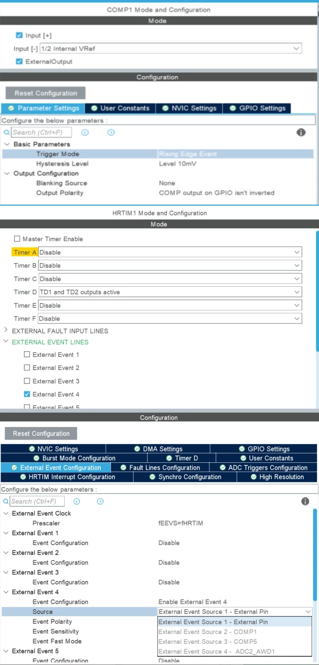

G474 problem connecting COMP1 output to HRTIM event4 source
What am I missing ?
The connection to the event source is grayed and non selectable, see screen copies of the configuration below.

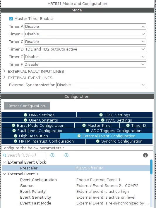

November 20, 2023
here... :)
just rename txt to ioc . (ioc upload not allowed here - maybe STM dont know, what this ioc should be ...)

AScha.3
November 19, 2023
i tried ...but: deselect external in comp
+ not select ext
-> if event4 not possible, use other event (1 or 2...)
try it.

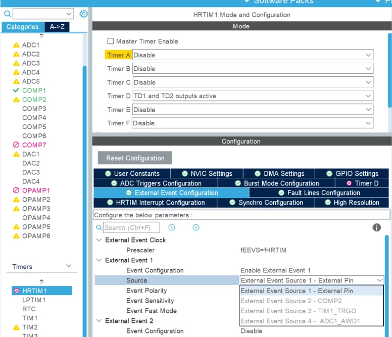

jose luuAuthor
November 20, 2023
I initialized COMP2 and tried to select it: it is still grayed, -> something is preventing the selection.
On your side, it seems that you are starting from an already complex configuration (since PA0=COMP1_OUT was busy), could you try recreating a project from scratch, only selecting the processor G474 and configuring COMPx and HRTIM ?
Also I am using the latest cubeMX: 6.9.2, which version do you have ?
AScha.3
November 20, 2023
ok... (in ide 1.13.1 ) + cube G4 1.51 (actual download) for G474RET6 :
i just set master timer on, not select any "external" in comp and hrtim event .
in your pic -> timer D has red cross -> you set something wrong there, clear this ! (cube shows you message, when mouse over the wrong item there , whats wrong)
jose luu
jose luuAuthor
November 20, 2023
Could you attach your .ioc file so I can peruse it ?

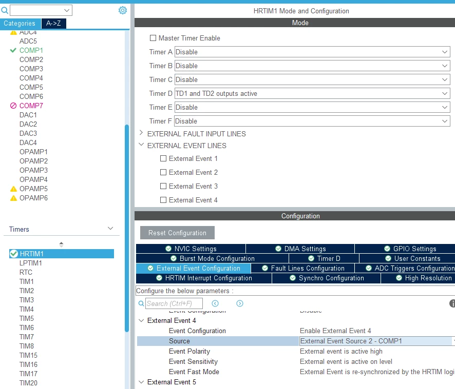

Thanks, resolved:
SOLUTION SUMMARY:
 the trick is to  *NOT* select "External event 4" in the upper "EXTERNAL EVENT LINES" topic but *enable* "External event 4" in the lower "External Event Configuration" pane.
