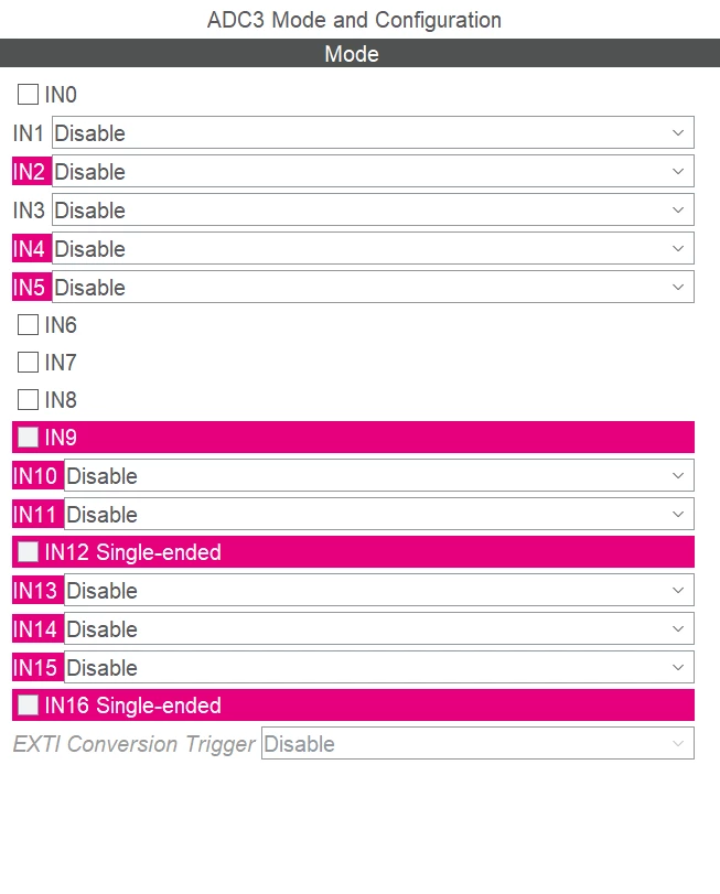

FW_H7 V1.11.2 broke ADC configuration selections
Ops!!!  The latest firmware does support internal channel selection on ADC3.

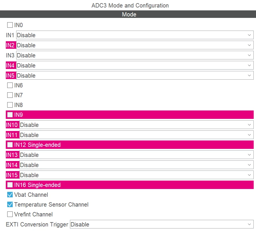

I verified that the previous firmware V1.11.1 gives visibility to the ADC3 internal channels for VBat, Temperature, and RBUF.  But if the firmware is migrated to V1.11.2 those selections disappear.
Screen shot from V1.11.2: After migration.
Before migration (V1.11.1):
I have also verified that starting a new project from scratch using any STM32H743 automatically applies V1.11.2 to start and once this happens, the internal channels are no longer available if if you change the firmware back to V1.11.1.

Hello @GreenGuy,
Please download and use the latest patch release of STM32CubeMX v 6.11.1 which contains the fix.

mƎALLEm
April 30, 2024
It's an already known regression on CubeMx 6.11.
See this thread: https://community.st.com/t5/stm32cubeide-mcus/h7-adc3-does-no-longer-offer-selection-for-temperature-after/m-p/652476
(internal ticket 176638)
