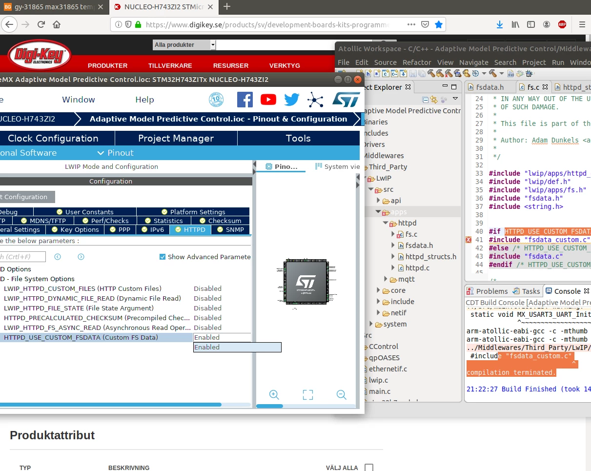

Hi!
I trying to follow this manual to set upp a HTTPD web server in STM32 Nucleo H7 board. But I got a issue because fsdata_custom.c is missing and it seems that I cannot set HTTPD_USE_CUSTOM_FSDATA to false neither. Is this a bug in CubeMX?
How can I solve it? I posted a screen shot and it will give you all the information about my board I'm using. 0690X00000ArJYmQAN.png

See p.8 about the fsdata.c file.

That's about file fsdata.c, not fsdata_custom.c

Just change the filename in either place.

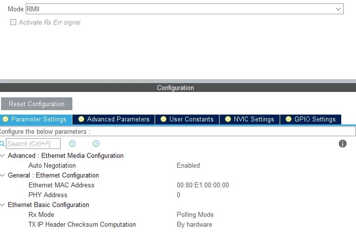

Hello!
I'm also trying to get a simple ping answer from my STM32F767 according to start point pdf description. But with no results.
Could you please help me a little bit to understand the issue I have?
I have connected my custom board with LAN8742a with a Ethernet cable directly to my PC and just try to ping the Board.
I have disabled to whole HTTPD option, so I don't care abot the missing files for now.
My settings for the ETH are:
Nothing change for the PHY settings (default LAN8742a) and the interrupts are enabled. GPIOs are double checked.

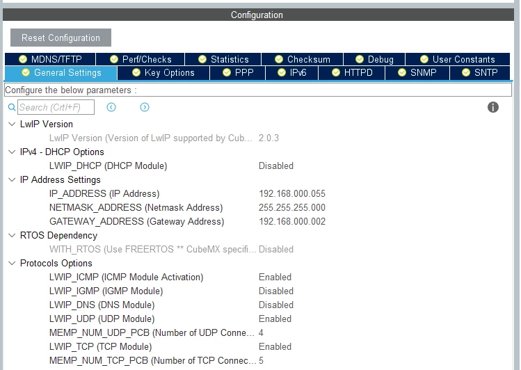

My settings for the LwIP are:0693W000004KAMwQAO.pngAnd here is my main:

Any ideas what I'm doing wrong?
