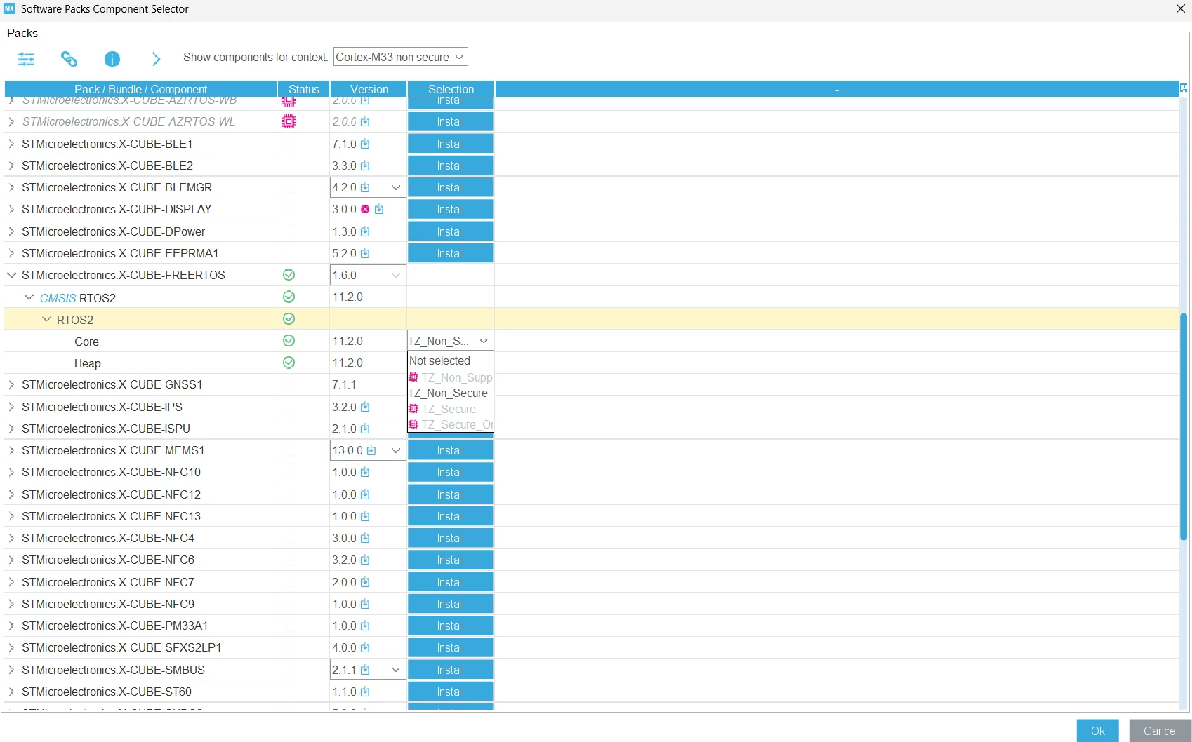

I was trying to solve the issue of this ticket:
But, as you can see on the image that I am sharing, I cannot change the FreeRTOS type zone. How can make my project work?

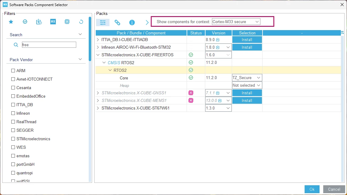

Hello ​@Fin95
Further to your comment, under Software Packs Component Selector you need to show the components for context:
M33 secure and enabling the STMicroelctronics X.CUBE-FREERTOS.

Hello ​@Fin95

Hello ​@Mahmoud Ben Romdhane,

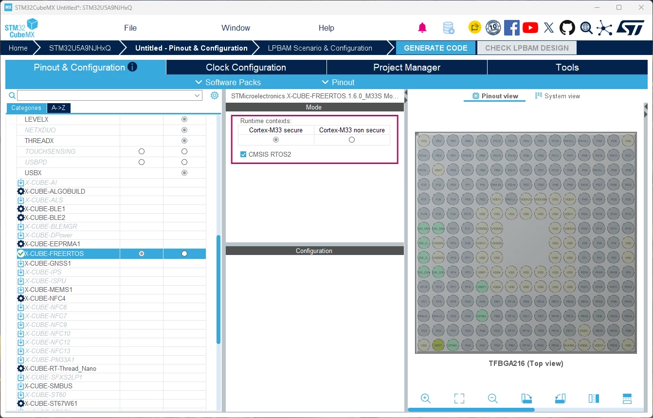

now the problem is fixed! Thank you so much!
Only to clarify, now I see two Middleware Freertos for TS e NTS. In the TS, as shown in your image above, is it correct to see no choices to set new task or other Freertos items?

Hello ​@Fin95
Further to your comment, this the expected behavior,
Queues and FreeRtos functionalities are supported only on the non-secure context.
