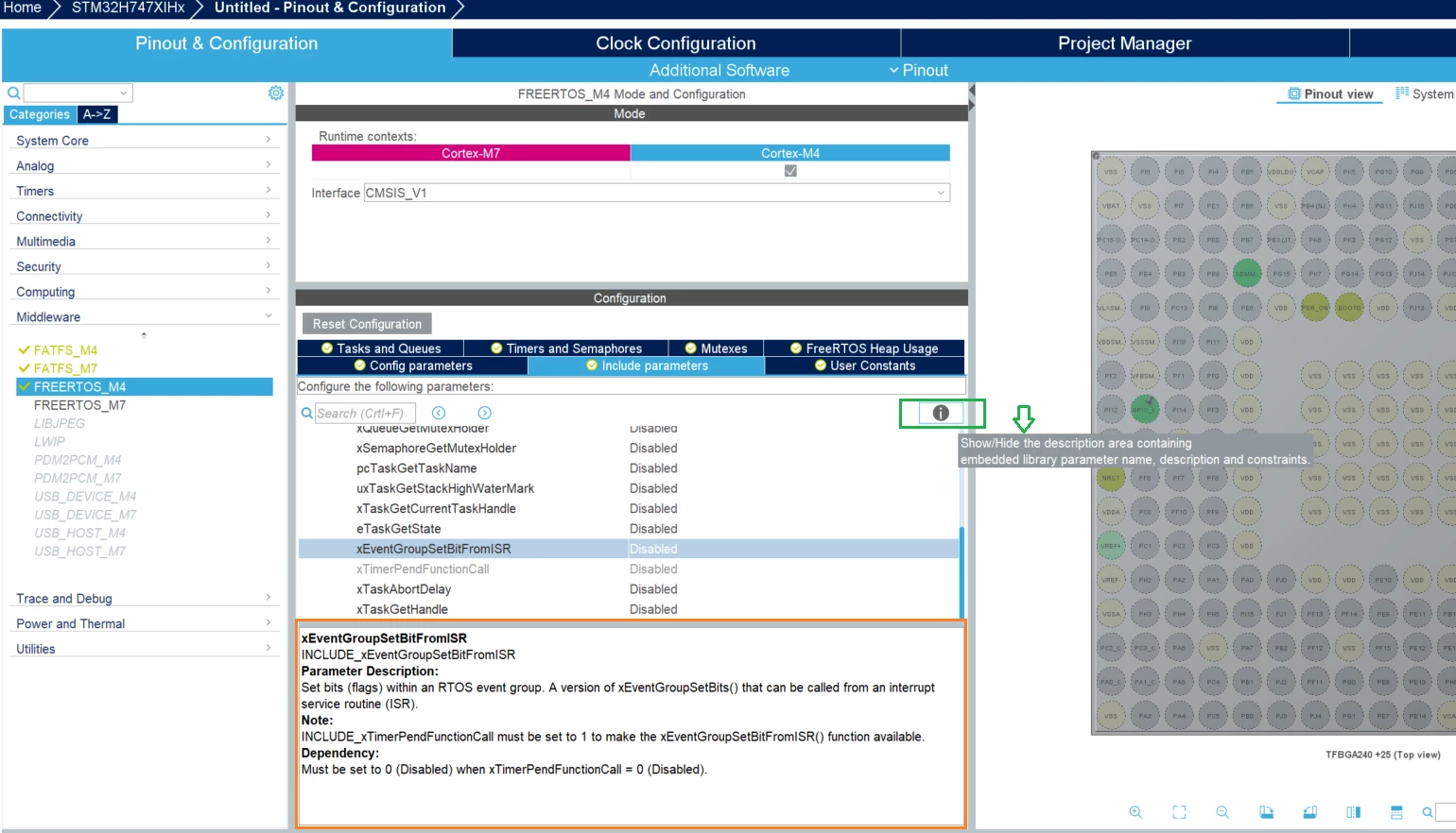

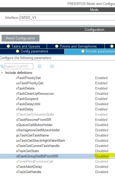

I wanted to test event groups to replace a bin semaphore and as the title says, i can't enable xEventGroupSetBitFromISR on CMSISv1 nor CMSISv2 wrappers.
Is there another way to enable that function? Maybe in a unofficial way?

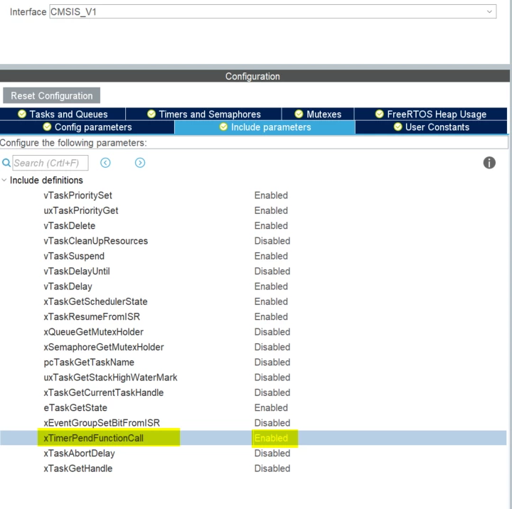

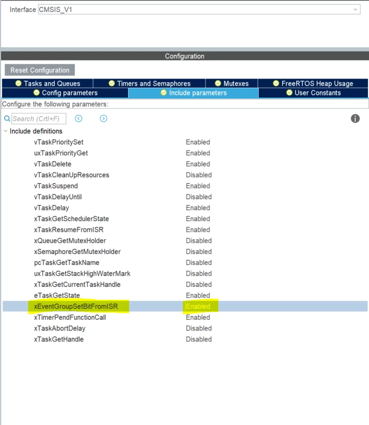

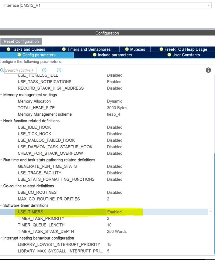

​Hello @Carlos Diaz R.​ , YES, you can enable "xEventGroupSetBitFromISR" from CubeMX.
Please Follow steps below.
1-Enable Use_TIMERS
2-Enable : xTimerPendFunctionCall
-> 3- xEventGroupSetBitFromISR can be enabled

​Hi @Carlos Diaz R.​ , It's too simple , just click on this icon and it will guide you :) .
Best Regards,
Khouloud.

I didn't saw the information button before, how silly of me. Thanks for your help :smiling_face_with_smiling_eyes:
