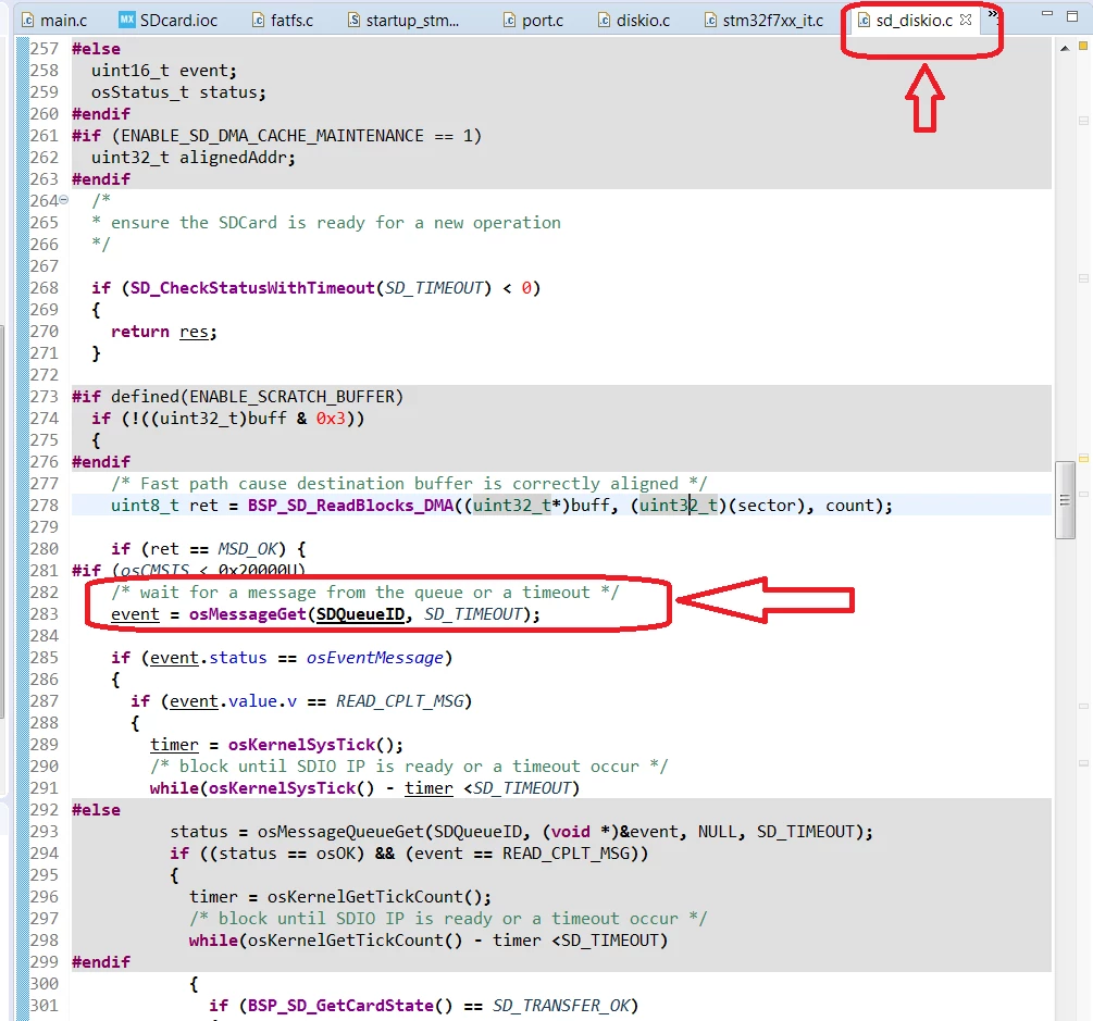

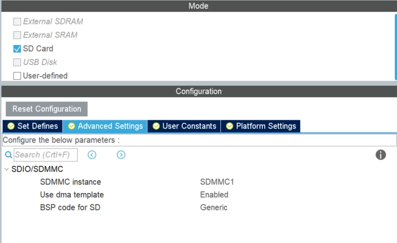

I have the same problem. I debugged and noticed that in the f_open() function, the program stays in this line and does not continue:
I use STM32F779. I attached the .ioc file.
