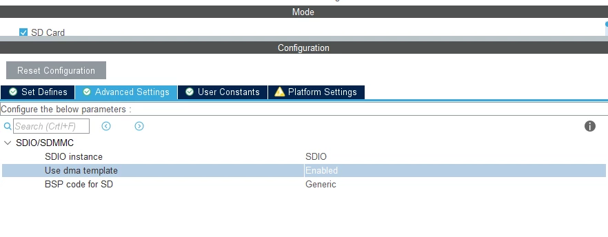

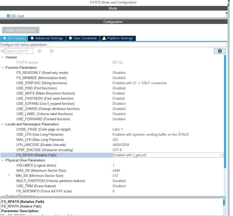

hello, ı want to communicate sccard via sdio with fatfs . in while loop and before while my code is working. but my code is not working timer callback and gpio external callback. this error is fr_disk_error or fr_no_filesystem. ı searched everything but happened.
cube Version: 1.5.1
may you help me pleas. how to solve this error (return = fr_no_filesystem)
thank you advance

But in your case, maybe you haven't configured well your NVIC Priority. Maybe you set Priority of Timer or EXTI higher or equal with SDIO DMA.
Ayuks.1
Visitor II
January 10, 2021
thank you brother ı changed nvic priority well work.
