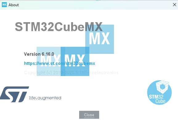

Hello @ikhwan-affan
Please try to use the latest version of STM32CubeMX 6.16.0
THX
Ghofrane
December 9, 2025
Thanks for the reply, but I still cannot find it from my side. I think it's better for me to give my setup environment:
OS: Windows 11
STM32CubeMX: Version 6.16.0
MCU: STM32H755ZITx
I realized that you are using STM32H755BITx but does it only available for that MCU and not STM32H755ZITx?
Thanks
