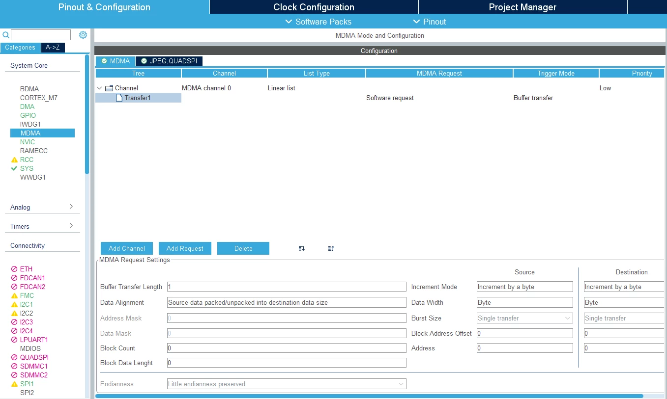

Our project uses an STM32H743VIT and we are building the project on Cube rev. 1.7.0.
Currently we use the HAL function HAL_SRAM_Write_8b to control a display on address 0xC0000000 on bank 1. (the display has an onboard controller SSD1351 setup for 8bit parallel mode) and it works perfectly fine.
To offload the CPU we would like to use DMA. Calling the function HAL_SRAM_Write_DMA revealed that hsram->hmdma was not configured so I tried to connect these together using the Configuration tool. Usually, there is a DMA settings tab in the configuration but it is not visible for the FMC. Some googling later it seems we need to use the MDMA module so I have enabled it with a software request.
I was expecting to find a way to have the configuration tool generate the code for me to link the DMA to the FMC but found no way so I changed xx_hal_msp.c to

After some more digging I found that:
The MX_DMA_Init routine does not set the initialize Request type to MDMA_REQUEST_SW although I would expect that because of the Config tool setting. Maybe it's a wrong assumption. If I put that in manually, like so (inside the also previously non existing and therefore automatically deleted USER CODE block):

The hardware pushes out one byte. Also, after that, the TCIF bit is set. The HAL_MDMA_IRQHandler is still not triggered.
If I change the trigger mode to:
hmdma_mdma_channel40_sw_0.Init.TransferTriggerMode = MDMA_FULL_TRANSFER;
4 bytes (?) are pushed out, and the IRQ is triggered. The HAL_SRAM_DMA_XferCpltCallback is also triggered and I'm free to call for a new transfer.
Although it looks like progress it does not yet make me confident I have set everything up correctly to continue.
Hopefully it helps to identify where I'm going wrong, or point me in the right direction.
Another potential wrong assumption is that because I have set the Buffer Transfer length to 1, and increment with bytes, it's allowed to only send out one byte and expect normal behaviour. Is 4 bytes the minimum?
