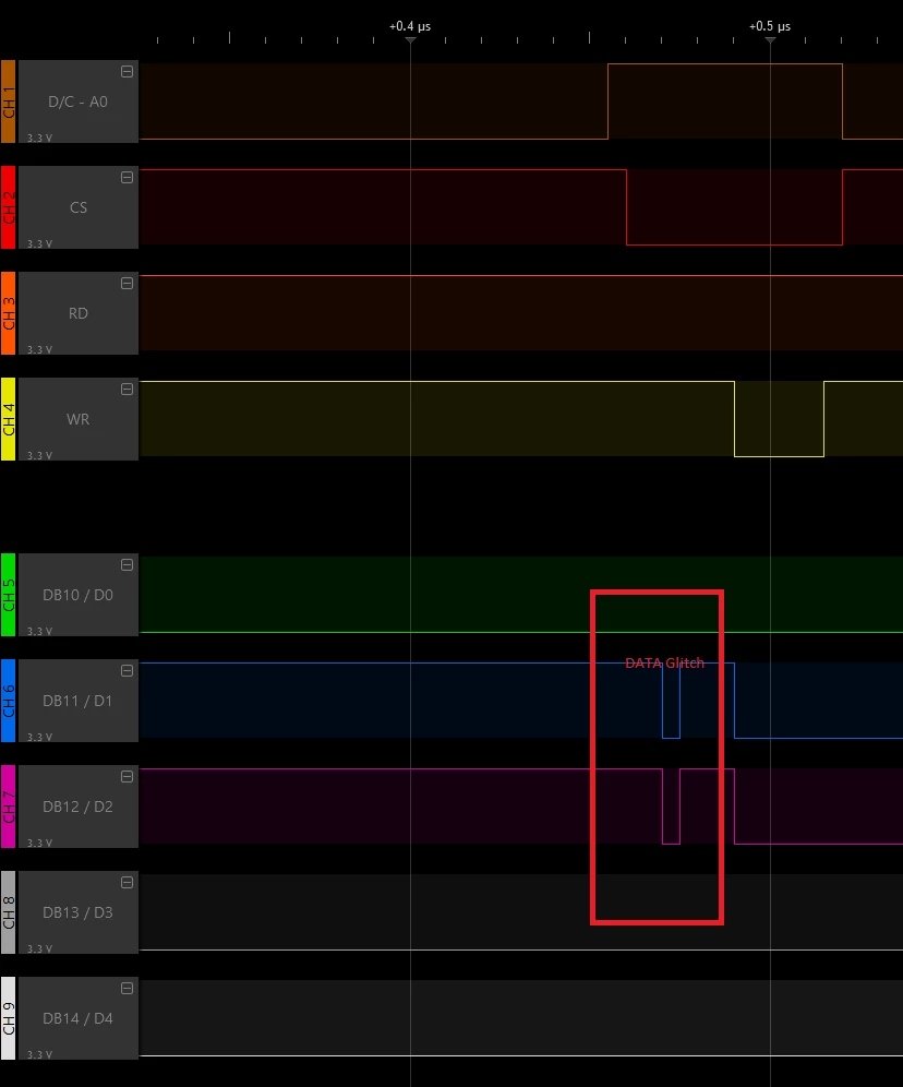

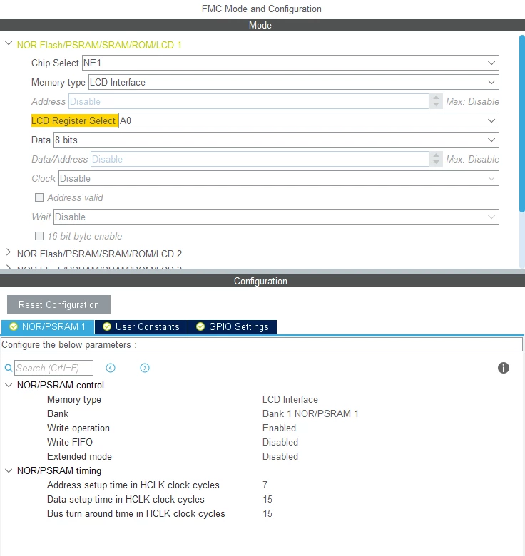

I am working on STM32F746ZG and I am trying to interfacing a display using FMC peripheral.
But actually I can't get it work... My display seems to receive some commands but I can't successfully send color.

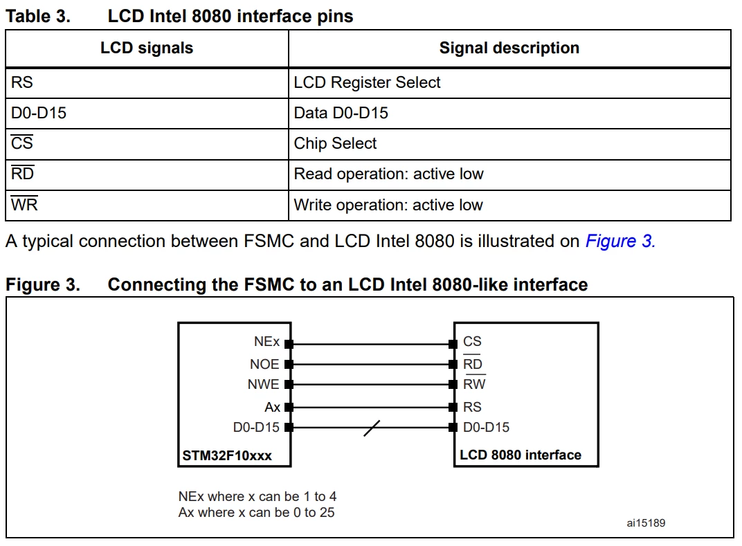

First of all I used CubeMX to configure my HW interface :
respecting A"N2790 TFT LCD interfacing with the high-density STM32F10xxx FSMC"
The generated code configured my FMC as :

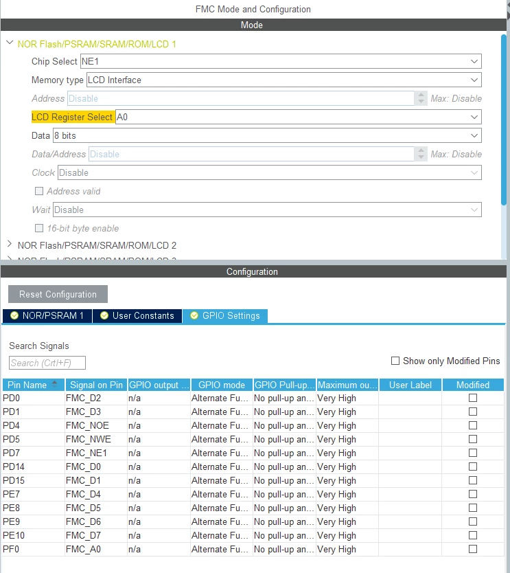

 /** FMC GPIO Configuration
 PF0 ------> FMC_A0
 PE7 ------> FMC_D4
 PE8 ------> FMC_D5
 PE9 ------> FMC_D6
 PE10 ------> FMC_D7
 PD14 ------> FMC_D0
 PD15 ------> FMC_D1
 PD0 ------> FMC_D2
 PD1 ------> FMC_D3
 PD4 ------> FMC_NOE
 PD5 ------> FMC_NWE
 PD7 ------> FMC_NE1

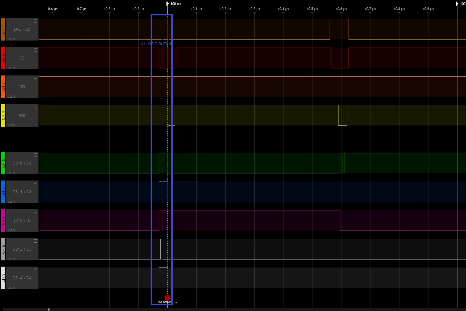

But its actually not works for some reasons. I measured each channel of my display interface and indeed I can see some glitch on the differents GPIO :0690X000009YuYmQAK.png
Why I got this glitch at first sent data ?. Which I got later on data :0690X000009YuZLQA0.png
Then, I tried to play with delay to works correctly and reduce delay between command and data :
Timing.AddressSetupTime = 1;
 Timing.AddressHoldTime = 1;
 Timing.DataSetupTime = 1;
 Timing.BusTurnAroundDuration = 5;
 Timing.CLKDivision = 1;
 Timing.DataLatency = 1;
But the result is very strange ... :
Delay is exactly same. But read GPIO changes.... I don't even try to read. Why I got this result ?
Finally, I got some questions about FMC mode :
How can I swap between 8080 or 6800 mode ? (I can't see any mode A,B,C or D which write with NOE toggle)
Sry for this long post I a new with FMC peripheral.

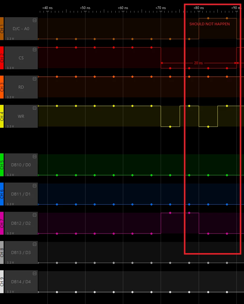

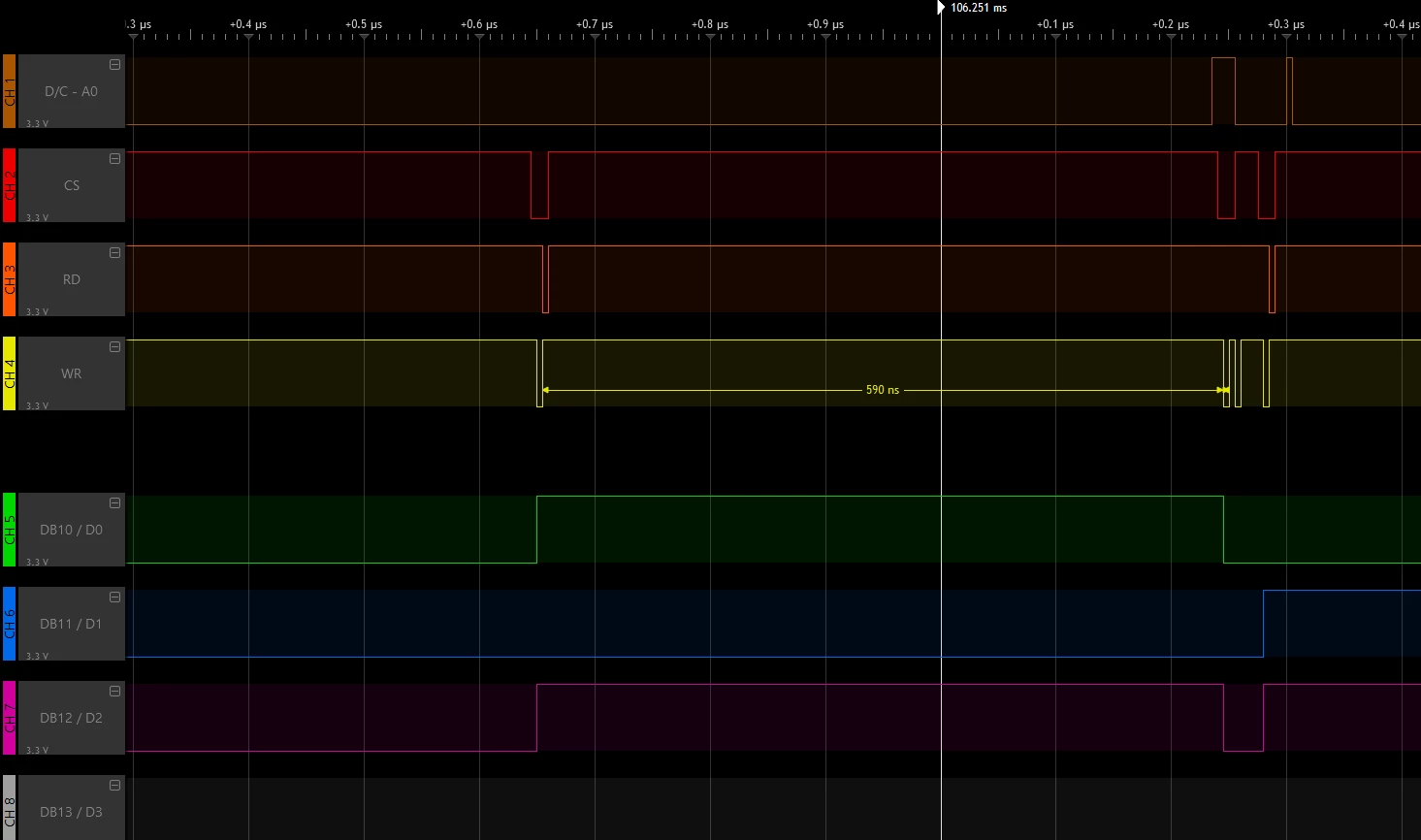

I successfully deleted the strange frame at start of transfer changing timing of AddressSetupTime to 0
Now my problem is that 2 write is done and Data/Sommand is changed. It shouldn't because I am trying to send only one command 0x040690X000009YvpyQAC.png
I don't understand why I got this.

Ok, well it's hard to tell without the context of how you're doing the writes, but it looks like it folded two writes, perhaps via the write buffering the Cortex-Mx.
Perhaps you should using some fencing commands/operations to separate the transactions?

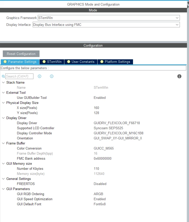

I should put also these configurations.
I am using an SEPS525 as Driver to control a display of 160*128 pixels.
I am using interface Intel 8080 with 8bits parallel for data actually.
first of all, I am just trying to write the register 0x04 (REDUCE_CURRENT) to 0x01 to power off my display.

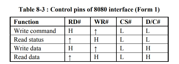

As my current mode is Intel 8080 transfer is done at WR rising edge as described :
So indeed, its not a real problem to have a "glitch" before the transfert (means rising up of WR).
My real problem is the second post when it seems to the bus to turn arround but I don't ask to read (I only write a register with LcdWriteReg(0x04);
GGher
Visitor II
August 23, 2021
I think you declared the command and data pointers as uint16 causing 2 8 bit transfer.
