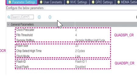

I have a question about the convention in STM32CubeMX to specify Flash size for QSPI and OCTOSPI.
The two application notes do not state the same thing.
Application note for QUADSPI says: "Flash size is 16 Mbytes => number of bytes in Flash memory = 2[FSIZE+1] = 2[23+1] => FSIZE = 23"

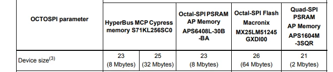

Application note for OCTOSPI says:0693W00000AP9mxQAD.pngWhich would mean that 24 stands for 16bytes.
So which one is true and which one should I use for the OCTOSPI

QUADSPI and OCTOSPI are different controllers.
You're reporting behaviour as described in the OCTOSPI App Note
21 = 2 MB
22 = 4 MB
23 = 8 MB
24 = 16 MB
DEVSIZE is a 5-bit field in OCTOSPI_DCR1, where 2^(DEVSIZE+1) is the size.
The initialization code takes the DeviceSize field and does the subtraction
So Init.DeviceSize = 24 defines a 16MB device
