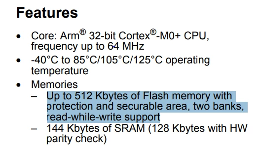

Hi, I write to report a possible bug in generating a project by selecting an STM32G0B1CB MCU.
I created the basic project using STM32CubeMX (6.9.0).
In the autogenerated file "stm32g0b1xx.h" (in Drivers/CMSIS/Device/ST/STM32G0xx/Include) there is the following define:
#define FLASH_DBANK_SUPPORT
However, the chip in question should have only one bank of 128kB.
Is this a bug or am I missing something?

August 29, 2023
@Mahmoud Ben Romdhane
> The Dual bank feature is supported in STM32G0B01 MCU devices.
The STM32G0B1CB has 128kB of FLASH per the datasheet (and the OP).
There is no table in the RM which suggests it has dual bank support.
August 29, 2023
Hello @TDK
Related to the Datasheet, the chip has two banks.
Thanks.
