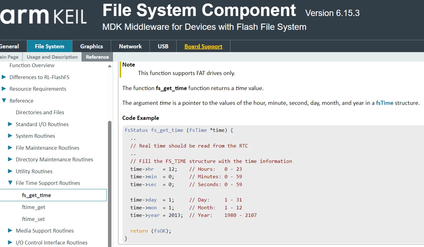

File created on SD Card shows incorrect creation time.
shown in above fig in red all files which gets created on SD card carry same creation time.
Wondering if missing something in CubeMX settings

a) You'd need something on the system maintaining current time.
b) Function in DISKIO layer providing get_fattime() from the aforementioned.

It's a call-out function from within the FatFs implementation, it is there for YOU to furnish current time upon request. You can recover it from the RTC, or your own SYSTEMTIME ticker, or whatever.
It uses this to fill in the fields of the file system structure you currently see as 1-Jan-2016 4:00 AM

aahsanAuthorBest answer
November 8, 2023
Seems like I need to do something like this for kiel5 to resolve the issue.
aahsanAuthor
November 10, 2023
With fs_get_time() implemented I can get creation time on the file correct.
