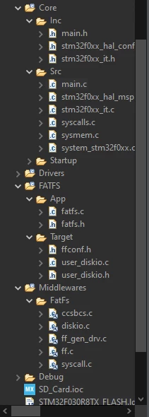

Hello Everyone!
I've tried to configure SD Card to STM32F030R8T6 via SPI1.
For reference I took this link: https://controllerstech.com/sd-card-using-spi-in-stm32/
After configuration CubeMX in STM32CubeIDE I've got the start code.
0693W00000HrRa0QAF.pngWithout any other coding I builded the project, just to avoid any possible errors.

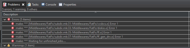

When build has finished I've got 5 errors as shown on the picture below.
0693W00000HrRaoQAF.pngIf anyone get experience how to configure correctly the FATFS?
I'll be much appreciate if you share with me.
Thanks in advance

Should be some other errors indicating why it didn't build the sub-components, or indications that it put the compiled objects in some other build directories, and not the source directories.

Where can I find other errors?
From Console?

Here below the Console Errors during Build:
№/STM32Cube/Repository/STM32Cube_FW_F0_V1.11.3/Drivers/CMSIS/Include" -I../FATFS/Target -I../FATFS/App -I"C:/Electronics/ST/Projects/STM32CubeIDE/SD_Card/FATFS" -I"C:/Users/Іван Уранковський/STM32Cube/Repository/STM32Cube_FW_F0_V1.11.3/Middlewares/Third_Party/FatFs/src" -O0 -ffunction-sections -fdata-sections -Wall -fstack-usage -MMD -MP -MF"Middlewares/FatFs/ff.d" -MT"Middlewares/FatFs/ff.o" --specs=nano.specs -mfloat-abi=soft -mthumb -o "Middlewares/FatFs/ff.o"
arm-none-eabi-gcc "C:/Users/Іван Уранковський/STM32Cube/Repository/STM32Cube_FW_F0_V1.11.3/Middlewares/Third_Party/FatFs/src/ff_gen_drv.c" -mcpu=cortex-m0 -std=gnu11 -g3 -DDEBUG -DUSE_HAL_DRIVER -DSTM32F030x8 -c -I../Core/Inc -I"C:/Users/Іван Уранковський/STM32Cube/Repository/STM32Cube_FW_F0_V1.11.3/Drivers/STM32F0xx_HAL_Driver/Inc" -I"C:/Users/Іван Уранковський/STM32Cube/Repository/STM32Cube_FW_F0_V1.11.3/Drivers/STM32F0xx_HAL_Driver/Inc/Legacy" -I"C:/Users/Іван Уранковський/STM32Cube/Repository/STM32Cube_FW_F0_V1.11.3/Drivers/CMSIS/Device/ST/STM32F0xx/Include" -I"C:/Users/Іван Уранковський/STM32Cube/Repository/STM32Cube_FW_F0_V1.11.3/Drivers/CMSIS/Include" -I../FATFS/Target -I../FATFS/App -I"C:/Electronics/ST/Projects/STM32CubeIDE/SD_Card/FATFS" -I"C:/Users/Іван Уранковський/STM32Cube/Repository/STM32Cube_FW_F0_V1.11.3/Middlewares/Third_Party/FatFs/src" -O0 -ffunction-sections -fdata-sections -Wall -fstack-usage -MMD -MP -MF"Middlewares/FatFs/ff_gen_drv.d" -MT"Middlewares/FatFs/ff_gen_drv.o" --specs=nano.specs -mfloat-abi=soft -mthumb -o "Middlewares/FatFs/ff_gen_drv.o"
arm-none-eabi-gcc "C:/Users/Іван Уранковський/STM32Cube/Repository/STM32Cube_FW_F0_V1.11.3/Middlewares/Third_Party/FatFs/src/option/syscall.c" -mcpu=cortex-m0 -std=gnu11 -g3 -DDEBUG -DUSE_HAL_DRIVER -DSTM32F030x8 -c -I../Core/Inc -I"C:/Users/Іван Уранковський/STM32Cube/Repository/STM32Cube_FW_F0_V1.11.3/Drivers/STM32F0xx_HAL_Driver/Inc" -I"C:/Users/Іван Уранковський/STM32Cube/Repository/STM32Cube_FW_F0_V1.11.3/Drivers/STM32F0xx_HAL_Driver/Inc/Legacy" -I"C:/Users/Іван Уранковський/STM32Cube/Repository/STM32Cube_FW_F0_V1.11.3/Drivers/CMSIS/Device/ST/STM32F0xx/Include" -I"C:/Users/Іван Уранковський/STM32Cube/Repository/STM32Cube_FW_F0_V1.11.3/Drivers/CMSIS/Include" -I../FATFS/Target -I../FATFS/App -I"C:/Electronics/ST/Projects/STM32CubeIDE/SD_Card/FATFS" -I"C:/Users/Іван Уранковський/STM32Cube/Repository/STM32Cube_FW_F0_V1.11.3/Middlewares/Third_Party/FatFs/src" -O0 -ffunction-sections -fdata-sections -Wall -fstack-usage -MMD -MP -MF"Middlewares/FatFs/syscall.d" -MT"Middlewares/FatFs/syscall.o" --specs=nano.specs -mfloat-abi=soft -mthumb -o "Middlewares/FatFs/syscall.o"
arm-none-eabi-gcc: error: C:/Users/???????? ????????????????????????/STM32Cube/Repository/STM32Cube_FW_F0_V1.11.3/Middlewares/Third_Party/FatFs/src/option/syscall.c: Invalid argument
arm-none-eabi-gcc: error: C:/Users/???????? ????????????????????????/STM32Cube/Repository/STM32Cube_FW_F0_V1.11.3/Middlewares/Third_Party/FatFs/src/ff_gen_drv.c: Invalid argument
arm-none-eabi-gcc: fatal error: no input files
compilation terminated.
arm-none-eabi-gcc: error: C:/Users/???????? ????????????????????????/STM32Cube/Repository/STM32Cube_FW_F0_V1.11.3/Middlewares/Third_Party/FatFs/src/ff.c: Invalid argument
make: *** [Middlewares/FatFs/subdir.mk:34: Middlewares/FatFs/syscall.o] Error 1
make: *** Waiting for unfinished jobs....
make: *** [Middlewares/FatFs/subdir.mk:32: Middlewares/FatFs/ff_gen_drv.o] Error 1
arm-none-eabi-gcc: error: C:/Users/???????? ????????????????????????/STM32Cube/Repository/STM32Cube_FW_F0_V1.11.3/Middlewares/Third_Party/FatFs/src/diskio.c: Invalid argument
make: *** [Middlewares/FatFs/subdir.mk:30: Middlewares/FatFs/ff.o] Error 1
make: *** [Middlewares/FatFs/subdir.mk:28: Middlewares/FatFs/diskio.o] Error 1
"make -j4 all" terminated with exit code 2. Build might be incomplete.
18:58:52 Build Failed. 5 errors, 0 warnings. (took 609ms)
As I understand, some files are missing.
But, I don't know which files and where to put them.
