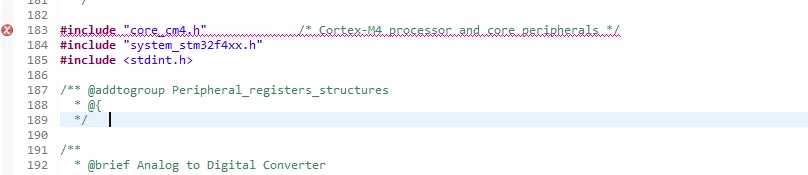

fatal error: core_cm4.h: No such file or directory stm32f407xx.h /test/Drivers/CMSIS/Device/ST/STM32F4xx/Include

This error occurs in the compilation of the project generated by stm32ubemx. How can I solve it.thank you.0690X00000BvbHWQAZ.png

The core_cm4.h header file is in <your projectfolder>/Drivers/CMSIS/Include. Either that folder was removed/renamed or its not in the include folder list. Generate a new project from scratch and compare/copy files and folders as needed.

Include Paths not properly set up, or local project directory where files not completely copied

You can try to remove embedded software packages and reinstall. Change version 1.28.1 to 1.28.0 worked.
I might have broken packages too. Because I installed offline. I cannot blame version.
