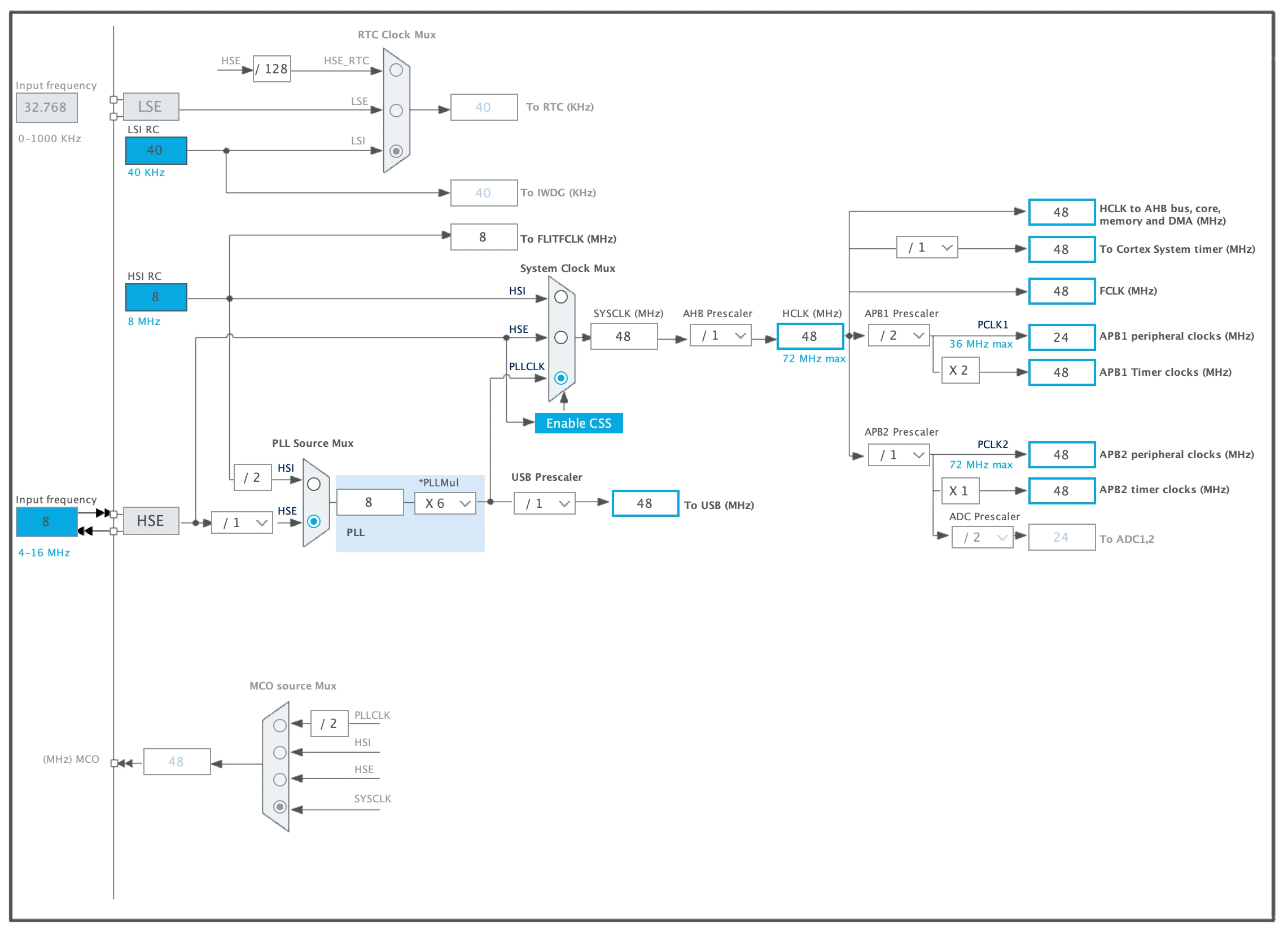

which generates code like this:
void SystemClock_Config(void)
 RCC_PeriphCLKInitTypeDef PeriphClkInit = {0};
 /** Initializes the CPU, AHB and APB busses clocks
 RCC_OscInitStruct.OscillatorType = RCC_OSCILLATORTYPE_HSE;
 RCC_OscInitStruct.HSEState = RCC_HSE_ON;
 RCC_OscInitStruct.HSEPredivValue = RCC_HSE_PREDIV_DIV1;
 RCC_OscInitStruct.PLL.PLLSource = RCC_PLLSOURCE_HSE;
 RCC_OscInitStruct.PLL.PLLMUL = RCC_PLL_MUL6;
 Error_Handler();
 RCC_ClkInitStruct.APB1CLKDivider = RCC_HCLK_DIV2;
 RCC_ClkInitStruct.APB2CLKDivider = RCC_HCLK_DIV1;
 if (HAL_RCC_ClockConfig(&RCC_ClkInitStruct, FLASH_LATENCY_1) != HAL_OK)
 Error_Handler();
 PeriphClkInit.PeriphClockSelection = RCC_PERIPHCLK_USB;
 PeriphClkInit.UsbClockSelection = RCC_USBCLKSOURCE_PLL;
 if (HAL_RCCEx_PeriphCLKConfig(&PeriphClkInit) != HAL_OK)
 Error_Handler();

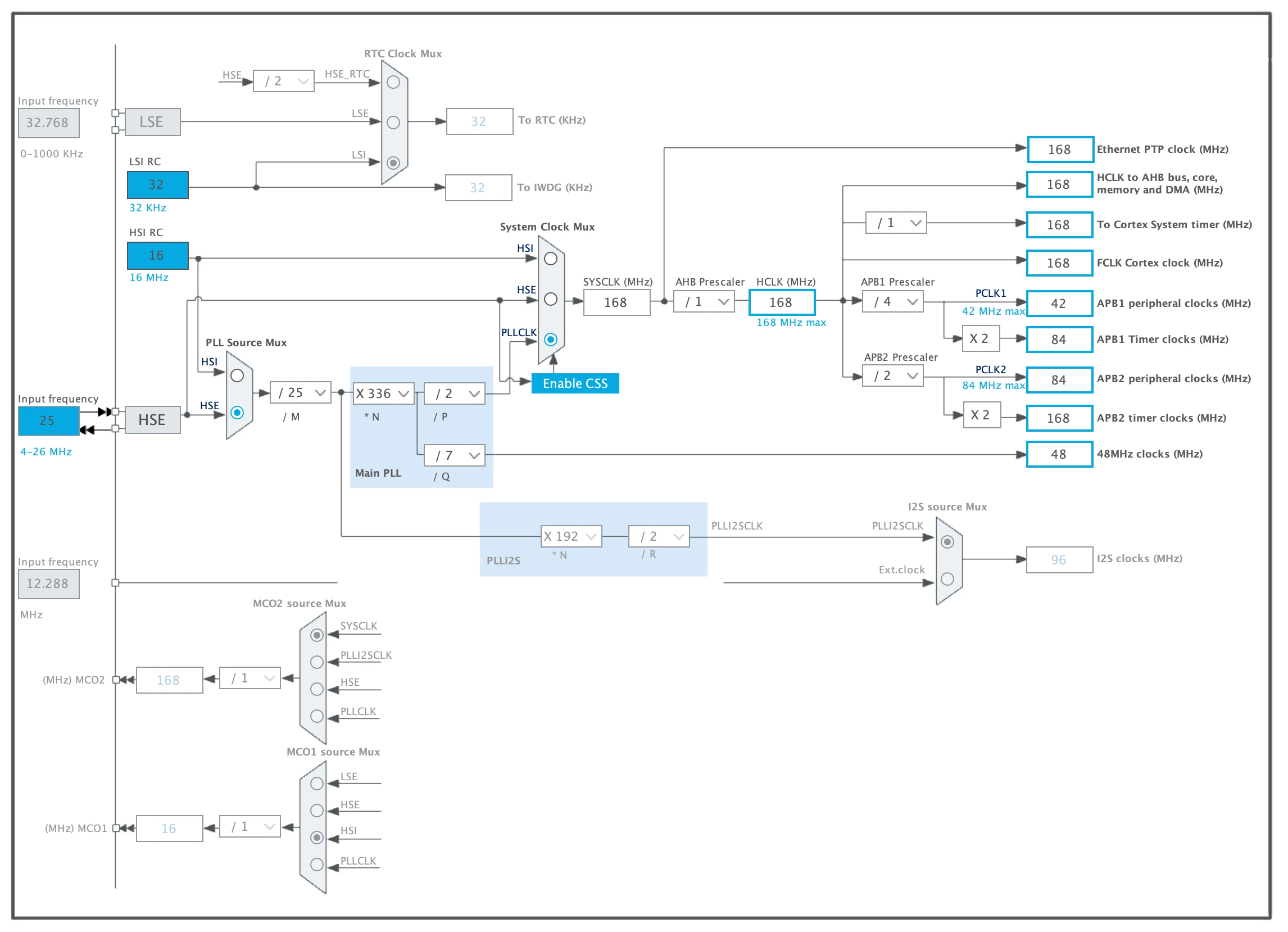

The F405 clock looks like this
​and the generated code looks like this:
 __HAL_RCC_PWR_CLK_ENABLE();
 __HAL_PWR_VOLTAGESCALING_CONFIG(PWR_REGULATOR_VOLTAGE_SCALE1);
 RCC_OscInitStruct.PLL.PLLM = 25;
 RCC_OscInitStruct.PLL.PLLN = 336;
 RCC_OscInitStruct.PLL.PLLP = RCC_PLLP_DIV2;
 RCC_OscInitStruct.PLL.PLLQ = 7;
 Error_Handler();
 RCC_ClkInitStruct.APB1CLKDivider = RCC_HCLK_DIV4;
 RCC_ClkInitStruct.APB2CLKDivider = RCC_HCLK_DIV2;
 if (HAL_RCC_ClockConfig(&RCC_ClkInitStruct, FLASH_LATENCY_5) != HAL_OK)
 Error_Handler();

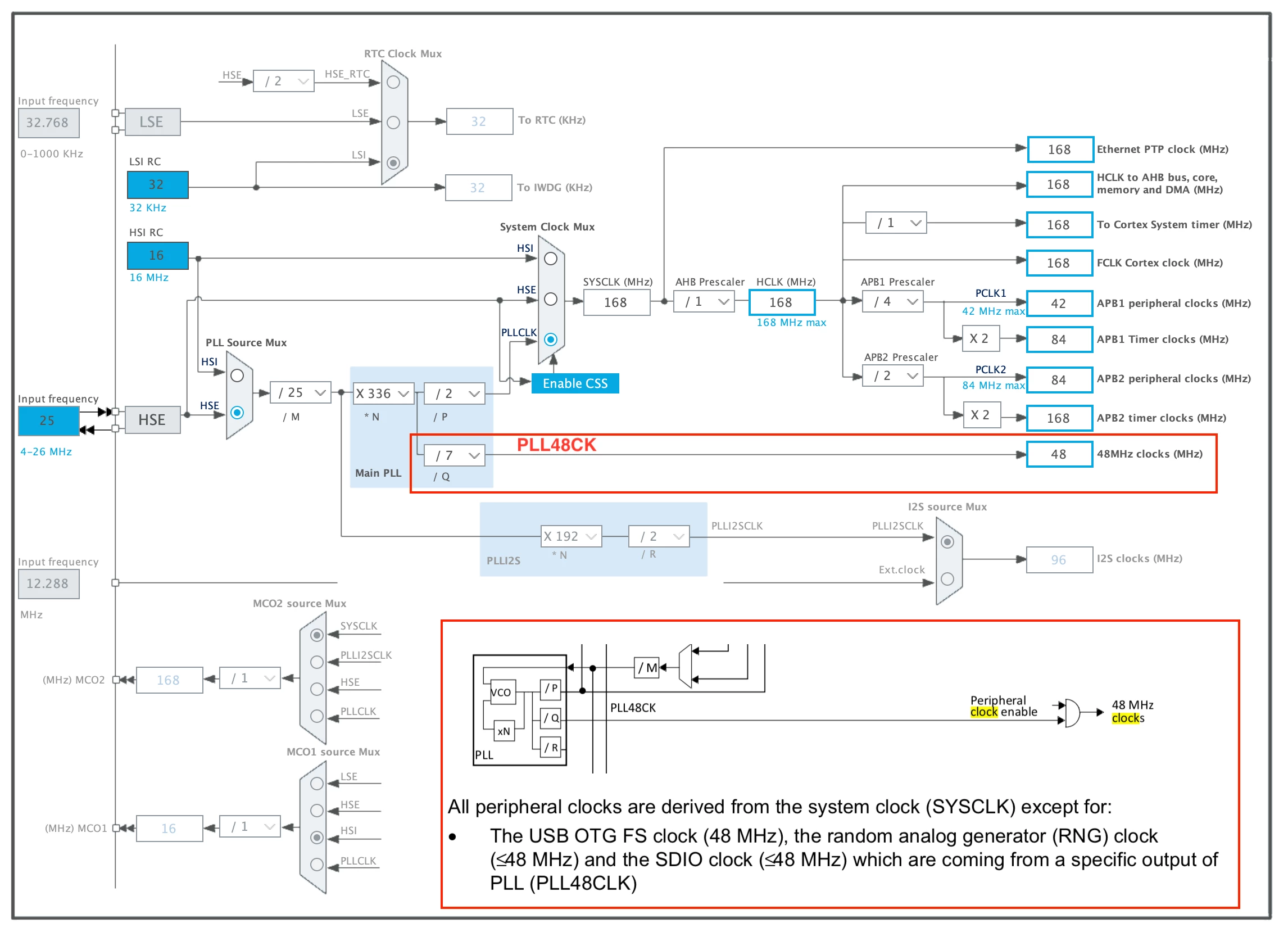

So where the F103 does something with a "peripheral usb clock" there is no such thing for the F405? There doesn't seem to be anything "usb" related in the F405 clock configuration screen... Does it use the "Main PLL -> 48 Mhz Clock (Mhz) (the one at the bottom)?

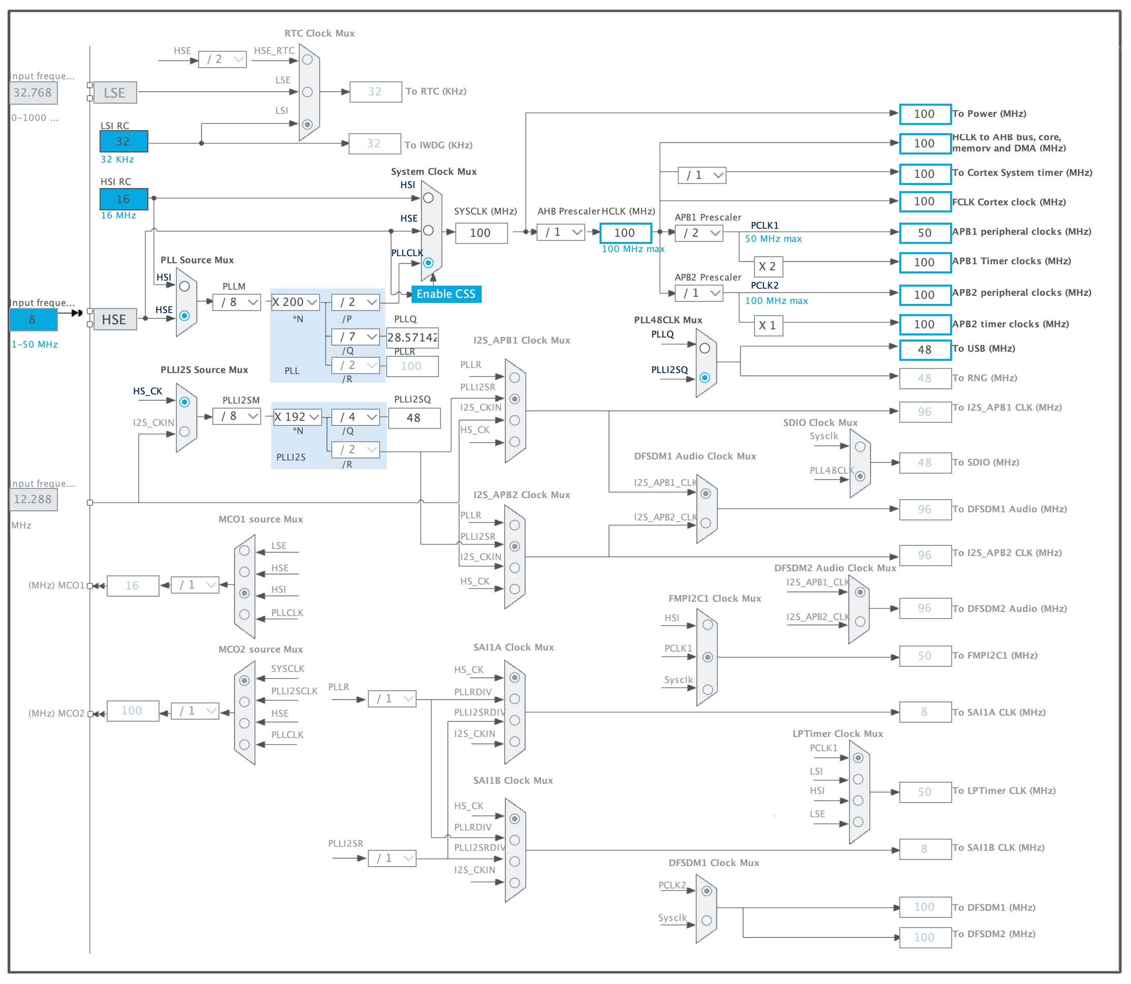

Looking at the MCU example pack for the F4, at an F413ZH (because it doesn't have samples for the F405), there's also some code to initialise Peripheral/USB, like this:
 /* Select PLLSAI output as USB clock source */
 PeriphClkInitStruct.PLLI2S.PLLI2SM = 8;
 PeriphClkInitStruct.PLLI2S.PLLI2SQ = 4;
 PeriphClkInitStruct.PLLI2S.PLLI2SN = 192;
 PeriphClkInitStruct.PeriphClockSelection = RCC_PERIPHCLK_CK48;
 PeriphClkInitStruct.Clk48ClockSelection = RCC_CK48CLKSOURCE_PLLI2SQ;
 HAL_RCCEx_PeriphCLKConfig(&PeriphClkInitStruct);

RCC_OscInitStruct.PLL.PLLQ = 7; // 336 / 7 = 48 MHz Q tap is USB/SDIO/CRYPT clock on F405, see Clock Tree in Reference Manual
RBoer
RBoerAuthor
August 10, 2019
Ah, I was looking at the Datasheet, instead of the Reference Manual.
So putting it all in 1 diagram, the Q line is the PLL48CK and is USB/SDIO/CRYPT on 48 Mhz ( it just shows "48Mhz Clocks" as there are multiple, instead of specifically mentioning "to USB" like it does for the F103 and "To USB / To RNG" for the F413 which additionally has a separate "To SDIO"). Since there is a direct connection from Q to "48Mhz Clocks" (i.e. nothing inbetween which needs configuring) it suffices to have initialization code for the "Main PLL"-block.
As for the F413, creating the clock configuration diagram from the sourcecode it looks like this:
... and here there is a "PLL48CK Mux" -block in which an input can be configured, so it makes sense the F413 has "extra" code for initializing that.
