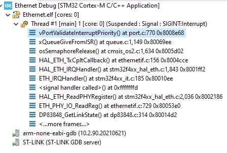

ASalc.1
ASalc.1Author
March 30, 2022
Hello @Aziz BRIGUI​ , thanks for your reply.
After adding those lines, once the first packet is sent (DHCP discover), it falls into the infinite loop of the next assertion (port.c , line 770):
configASSERT( ( portAIRCR_REG & portPRIORITY_GROUP_MASK ) <= ulMaxPRIGROUPValue );
0693W00000LwItEQAV.pngLooking at the trace, it seems that the problem is with the priority group having subpriority bits in the ETH interruption. The NVIC is supposed to be properly configured with 4 preemption bits and 0 for subpriority. The value of portAIRCR_REG is 0xfa050300 when it should be 0xfa050000...
