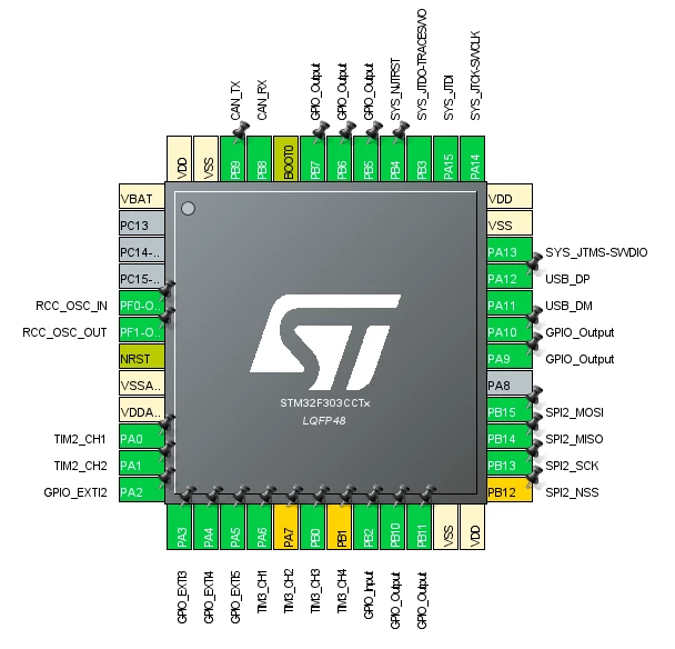

I set up several pins as EXTI in the CubeMX configurator, but STM32CubeIDE doesn't recognize the EXTI_InitTypeDef and NVIC_InitTypeDef datatypes. Based on the configuration I would expect the correct libraries to be included, but when compiling I get the error "unknown type name".
I get the error when I use the following code, which was originally written for some STM32F4, then adjusted for application on the STM32F303CC.

MAkke
MAkkeAuthor
January 27, 2020
It must be something like that all right. But how can it be missing? I did the setup through the GUI, so you'd think it would include all the necessary libraries. I do have an stm32f3xx_it.h and stm32f3xx_it.c, so which file are you referring to? How do I set the path?
