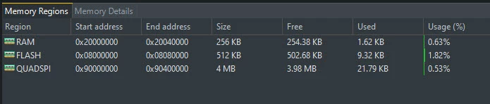

External QSPI Flash Memory (memory-mapped) and internal RAM
I have configured an External flash for the F412 chip. So I modified the STM32F412RETX_FLASH.ld like this:

Configured the QSPi for the memory-mapped and assigned an array like this to the external flash:

It works and I see the equipped memories like this:
However I see when I assign the data to the external memory, the RAM usage also descreases which I think it should not be like this, we have only changed the location of the data.
Is this normal?

Use "const"

May 23, 2021 8:50 PM UTC
That's it. Solved. Thanks.
