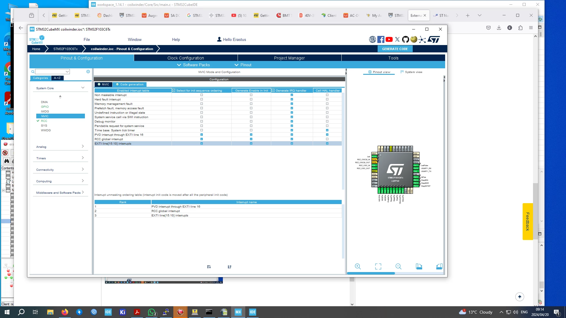

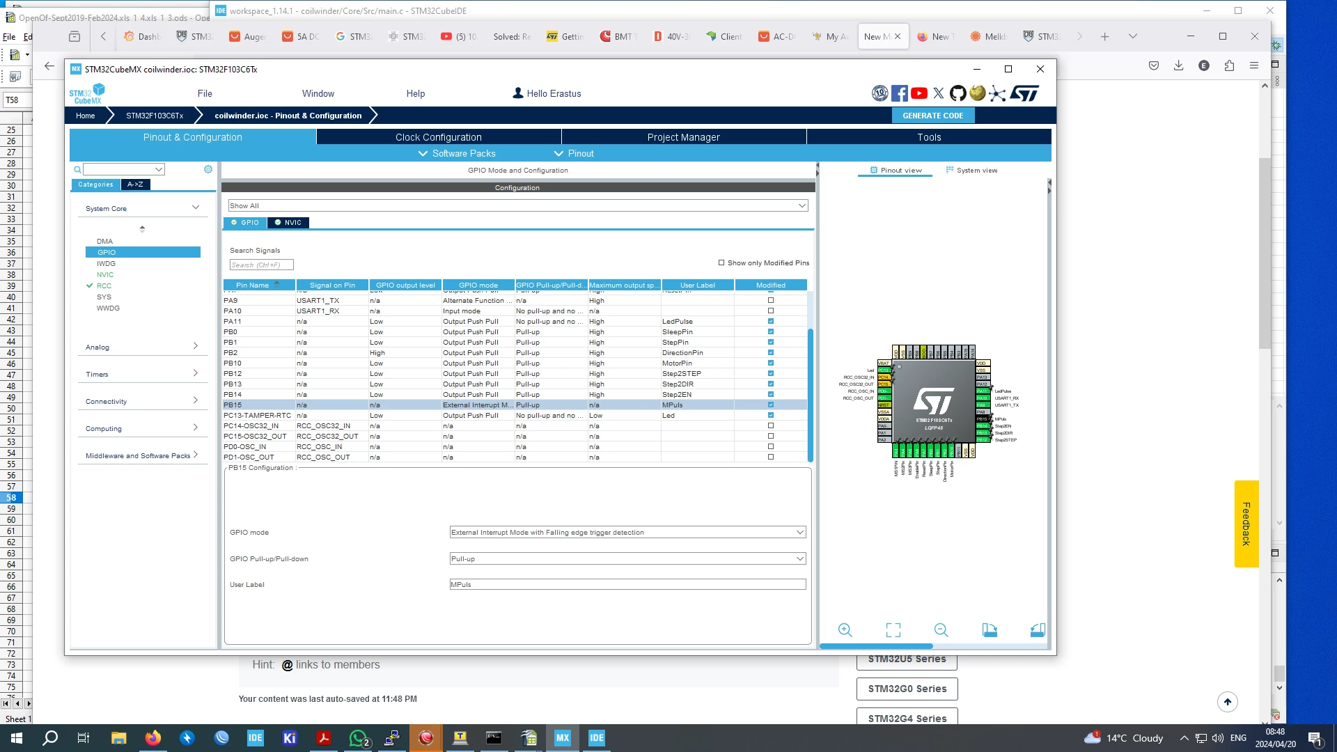

I am trying to catch a pulse on PB15. So I set the port PB15 to external irq with falling edge as per screen shot below
The code in MX_GPIO_Init() generated by MX is:
/*Configure GPIO pin : MPuls_Pin */
GPIO_InitStruct.Pin = MPuls_Pin;
GPIO_InitStruct.Mode = GPIO_MODE_IT_FALLING;
GPIO_InitStruct.Pull = GPIO_PULLUP;
HAL_GPIO_Init(MPuls_GPIO_Port, &GPIO_InitStruct);

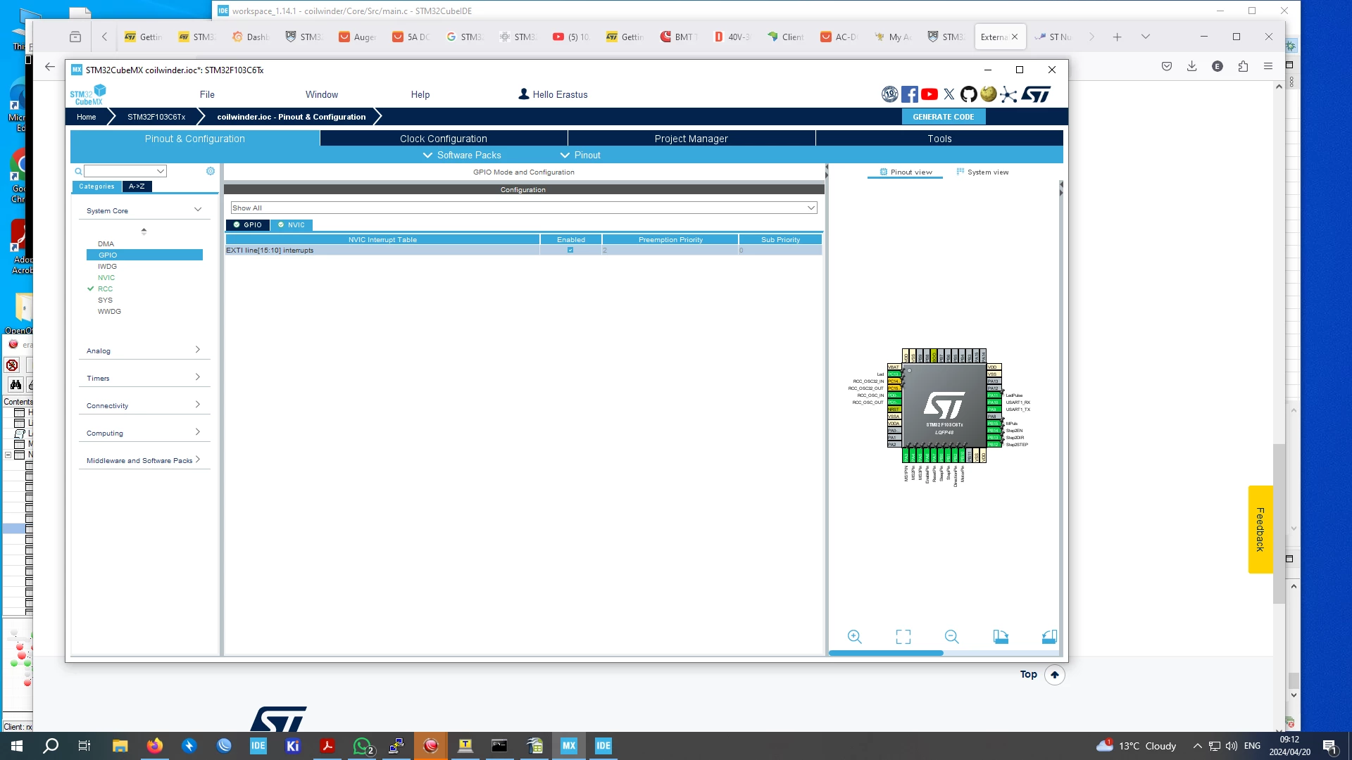

Primary check if EXTI in NVIC is checked.
erastusAuthor
April 20, 2024
Yes it is unless I am missing something
If I set the pin to read the IO I do get the level changes but not the IRQ
