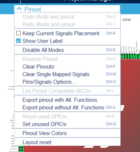

Oct 21, 2026 12:17 PM UTC
​@Andrew Neil
Hi sir, this ALT+L (list pinout compatible MCUs) this option is not able to do in this MCU.
