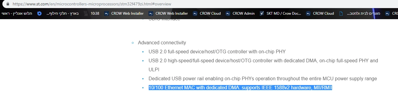

I'm working with STM32F479ZG and ZI both have working ethernet.
In the lastest CubeMX 5.1.0 it shows that those MCUs are not supporting ethernet.
Is there a work around for this issue?

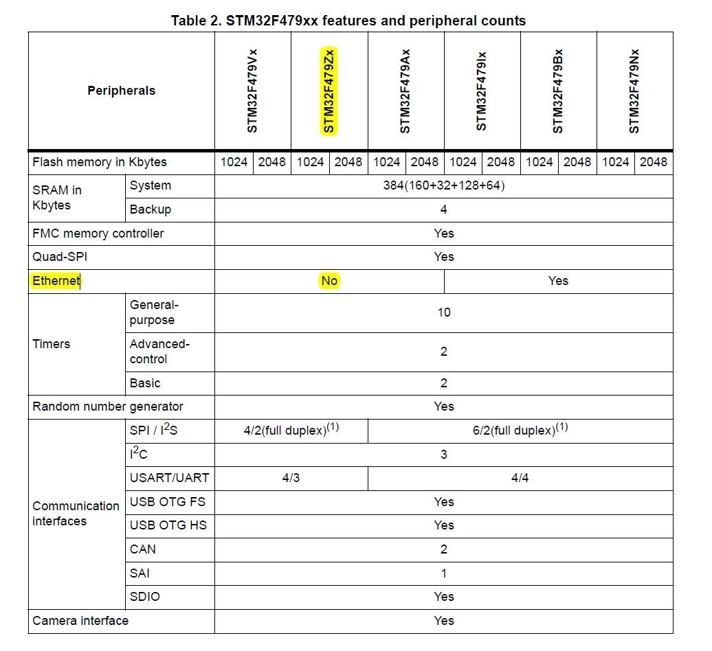

Khouloud ZEMMELI
Apr 22, 2019 8:08 AM UTC
​Hello @MPetr.17​
This's not an issue,  this MCU do not support Ethernet as it's indicated in the Datasheet.

MPetr.17
MPetr.17Author
Apr 22, 2019 8:16 AM UTC
Something must be wrong here.
Also I have a working Ethernet on this MCU, I just need the CubeMX to create a sketch of the MCU and its occupied pins.
Khouloud ZEMMELI
Apr 22, 2019 8:54 AM UTC
​@MPetr.17​
Those informations are generic  ( about STM32F479xx devices) , for specific information you need to see the Datasheet.

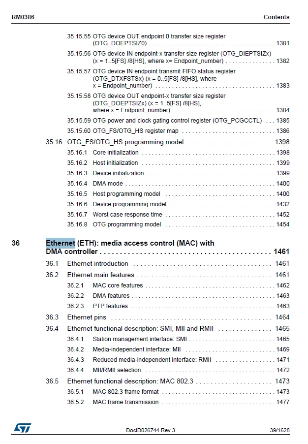

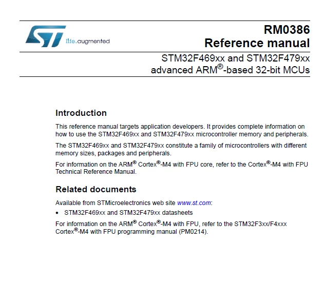

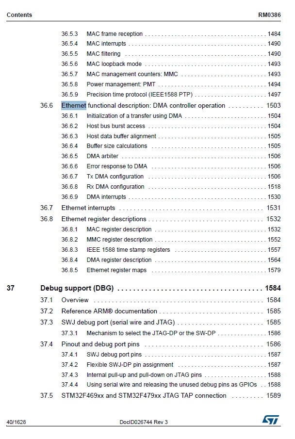

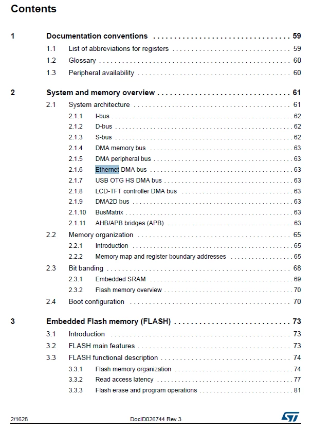

MPetr.17
MPetr.17Author
Apr 22, 2019 9:04 AM UTC
Also, here is a manual for it.
It does support Ethernet otherwise my Ethernet would not be working!
Amel NASRI
Apr 22, 2019 10:00 AM UTC
You need to select STM32F479I/B/N device, not STM32F479Z.
MPetr.17
MPetr.17Author
Apr 22, 2019 10:15 AM UTC
But we use the Z version of the MCU and it does support Ethernet!
You insist that it doesn't because someone made a mistake and wrote in some document that it doesn't.
It does work, we have 3 different board designs with the STM32F479ZG/I all of them have a working Ethernet...
Only the Z version has the right 144 pins that we use.
The I version has 176 pins
The B version has 208 pins
The N version has 216 pins
Those versions will create the illusion that we have more free pins than we actually have.
Amel NASRI
Amel NASRIBest answer
May 10, 2021 9:20 AM UTC
Dear All,
I come back to this old discussion to precise that Ethernet is not fully supported in STM32F479V/Z/A as well as STM32F469V/Z/A. That is why STM32CubeMX will not be updated (contrary to what I previously said).
Sorry for such confusion. This post comes to discard previous one.
