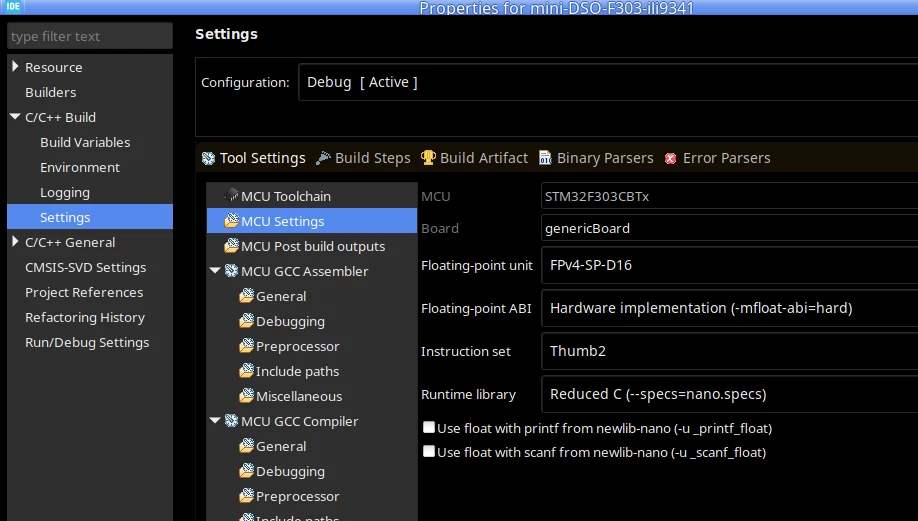

Errore "-u_printf_float"
Hi, i get this error, can someone please help me, thanks. I use Cube MX(STM32-cube-ide).
I tried to follow the steps but it didn't work.

In menu->project->properties set : "use float w. printf"
Giuseppe1Author
February 16, 2024
Thanks!
