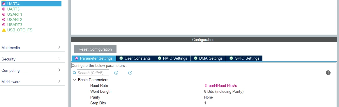

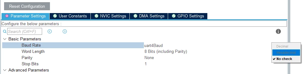

Error with custom baudRate cubeMX 6.1.1 [solved]
To configure my uart baud rate i use a variable on cube MX. To disable error i select "no check" in option --> that work find on previous version.
Now with version 6.1.1 the error stay even if i select "no check" with the version 6.1.1.
If you have an idea how to solve it !

Hi @MLE S.1​ ,
You need to declare all your variable in user constants and you can set your custom baud rate in the constants value.
Thanks!
Houssem

MLE S.1
MLE S.1Author
Dec 21, 2020 11:34 AM UTC
Thanks @Houssem CHAABANI​ for your rapid answer
Problem solved : just need to declare uart4Baud in user Constants to solve the problem !
