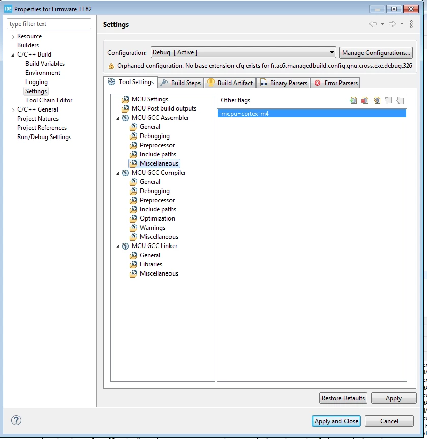

Piranha
Principal III
February 6, 2020
Guys, look carefully at the error - the instruction has an option "0xF". That is only supported in full ARM instruction set, but not in Thumb mode on Cortex-M3. The compiler is missing -mcpu=cortex-m3 parameter.

LDel .1
June 2, 2021
Hi, I had the same error, and found out you can add the "-mcpu=cortex-m4" flag in the "Miscellaneous" tab :0693W00000BZrtmQAD.png
