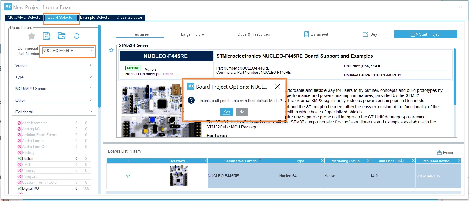

Error initialization default peripheral configuration of development board STM32F446RE using STM32cubeMX 6.2.0.
After access to board selector > STM32F446RE does not ask for the default peripheral configuration and it started as a plan board.
What can be the reason not initialization of the default pin of the board?
Thanks.

Hi @DRamo.1​ ,
Thanks for your feedback. Normally when selecting a board through Board Selector tab, a dialog window requesting to initialize all peripherals to their default mode will be displayed.
Selecting the NUCLEO-F446RE board to start a project, the initialization message will be correctly displayed:
Please make sure that you switch to Board Selector tab , and select the NUCLEO-F446RE board (with the mounted STM32F446RETx MCU).
I hope this helps you.

Have observed problem in the repository folder, after upgrading to the new version, old repository also need to be replaced. otherwise will never show the pop-up initialization message.
