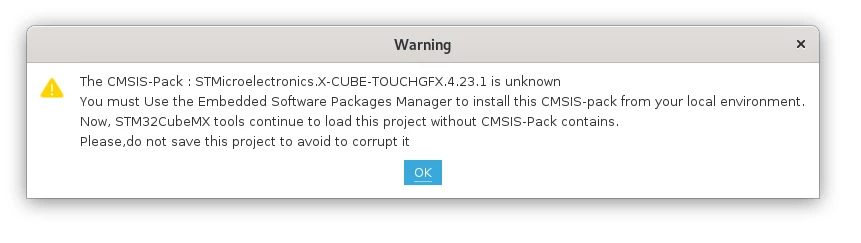

Error: "CMSIS-Pack : STMicroelectronics.X-CUBE-TOUCHGFX.4.23.1 is unknown" after restarting CubeMX
When i configure a project with CubeMX and TouchGFX Generator stuff and save this,
after a new start of CubeMX and opening the .ioc file again i get this error message:
forum_1.pngAnd my TouchGFX Generator Configuration is lost. The other configuration is still there.

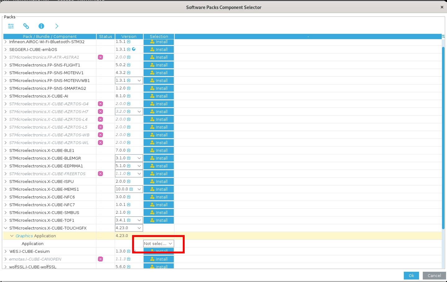

Now, under "Software Packs Component Selector" the Generator Application is "Not selected" although i selected the Generator Application in the previous session:
After selecting the Generator and Clicking OK button, the TouchGFX Generator is back, but not what i have configured there in the previous session.

Imen.DBest answer
Mar 27, 2024 7:32 PM UTC
Hello @sk-st ,
Please follow the steps that I have described in this post to download and install the X-CUBE-TouchGFX manually into STM32CubeMX.

Meanwhile i found a logfile in ~/.stm32cubemx/
The error message OK-Box is showed after
Begin LoadConfig()
in the Logfile.
Does this give some hints?

sk-st
sk-stAuthor
Apr 2, 2024 8:27 AM UTC
Hello Imen,
thank you for your help.
The problem does no longer occur.
