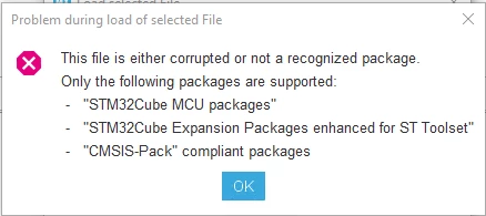

When attempting to install a package "From local" on a development PC that is offline, CubeMX rejects the package with the error message "package not recognized."
How can the package dictionary (XML file) be updated? This would be the offline equivalent of the "Refresh" button.

The package appears to be not compatible with STM32CubeMX. The “package not recognized” message  means the file is not in one of the formats CubeMX can install, such as an STM32Cube MCU package, an STM32Cube Expansion Package for ST tools, or a CMSIS-Pack compliant package. In this case, updating the local package dictionary would not resolve the issue, because the limitation is the package format itself rather than missing package information. If needed, the package may still be usable through manual integration into the project instead of installation through CubeMX.

To be precise, the package in question is this one:
  • https://www.st.com/en/embedded-software/x-cube-cryptolib.html#section-get-software-table
I am therefore surprised that this package is not supported by CubeMX.

Is it similar to I-CUBE-LRWAN, which is not a proper Cube “package” - just a collection of files/examples … ?
https://www.st.com/en/embedded-software/i-cube-lrwan.html
