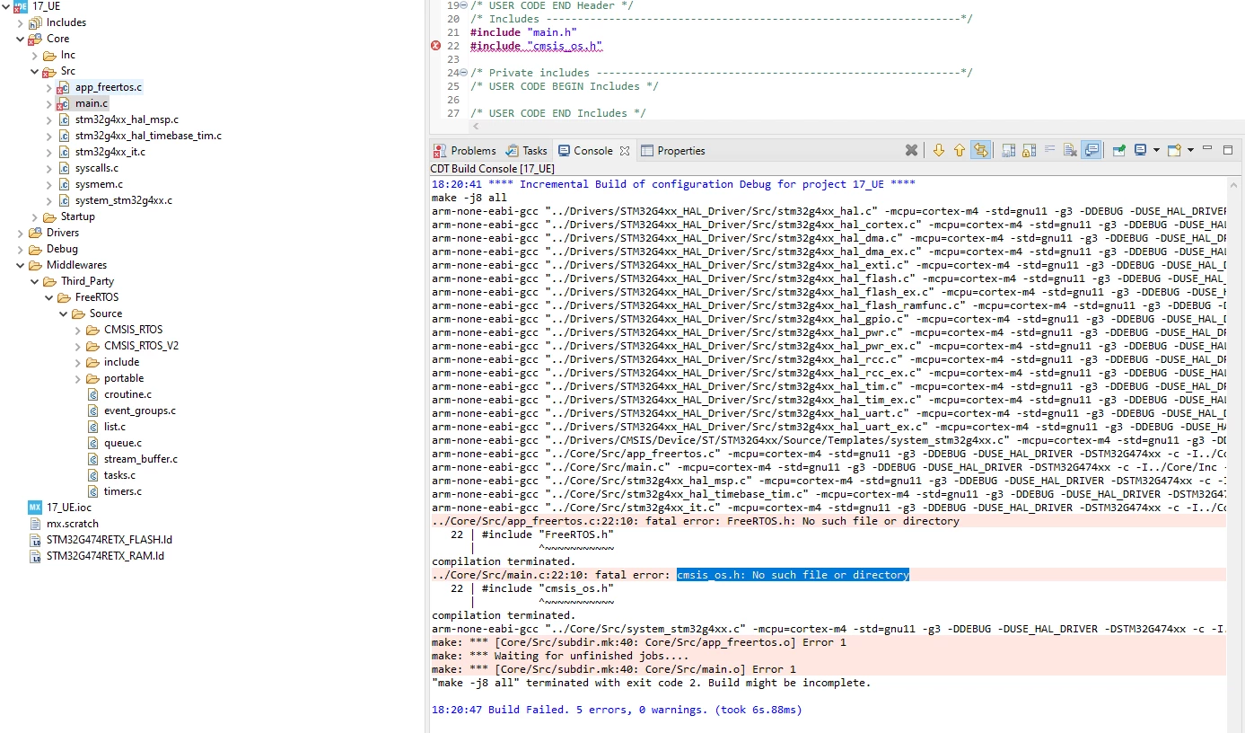

Doesn't find file in CubeIDE when compiling project "fatal error: FreeRTOS.h: No such file or directory" and "cmsis_os.h: No such file or directory"

I turn on freeRTOS in my project

Hello @AKruh.1​ ,
Thanks for your feedback,
Could you please share your ioc file ?
Thanks,
Sara.
AKruh.1
AKruh.1Author
Mar 2, 2022 4:06 PM UTC
Yes! I used cube 1.8 and 1.7 versions. Same. I am sending the file.
Sara BEN HADJ YAHYA
Mar 2, 2022 4:37 PM UTC
Hello @AKruh.1​ ,
Thanks for sharing the ioc file.
I assume that you didn't use CubeMX standalone, instead you used CubeIDE and the MX plugin.
I didn't face any issue from my side, I just opened the ioc using CubeMX standalone and then generated the project to CubeIDE.
I will try to do some more tests, in the meanwhile could you please share a detailed scenario that led to this issue.
I am adding @mattias norlander​  from CubeIDE team to the loop.
Sara.
AKruh.1
AKruh.1Author
Mar 2, 2022 5:22 PM UTC
Thanks! I downloaded Cube MX version 6.4.0. Created a project there and opened it with CubeIDE . And the error is gone!
I think it's some kind of bug in CubeIDE when you create a project with MX plugin!
mattias norlander
Mar 3, 2022 1:00 PM UTC
In the project where you face the build error.
Do you remember whether you have switched between CMSIS v1 and v2? We have a known bug, internal ticket reference 95887.
I have some colleagues who will try to re-produce, will return on this topic.
AKruh.1
AKruh.1Author
Mar 5, 2022 7:36 AM UTC
Yes. I changed. But the bug has always been there. I recreated the project and nothing changed. It only helped to create in CubeMX.
