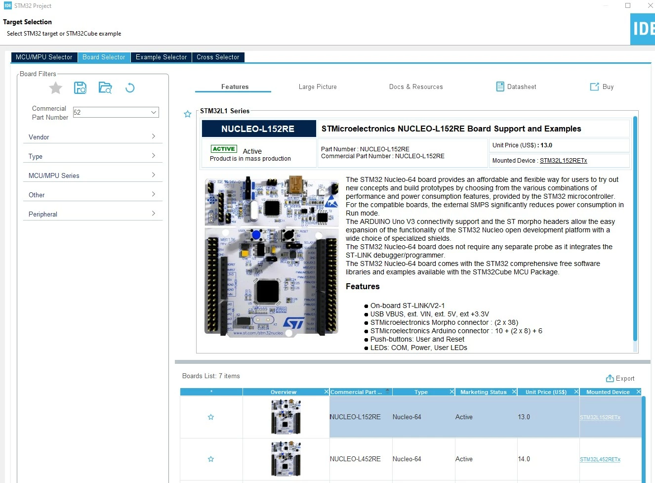

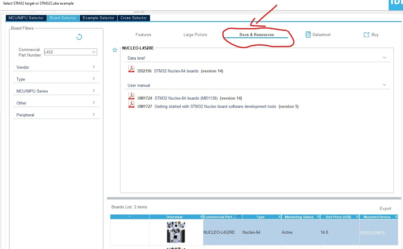

As mentioned in the previous comment by @Cartu38 OpenDev​ ( and thanks for your detailed explanation ), you can find all linked document needed on site or even on the tool itself.
In addition to the example provided when you choose your Part Number under Boad Selector, you can find other examples of code with a detailed note for each project under your repository path: \Repository\STM32Cube_FW_L4_V1.16.0\Projects\NUCLEO-L452RE .

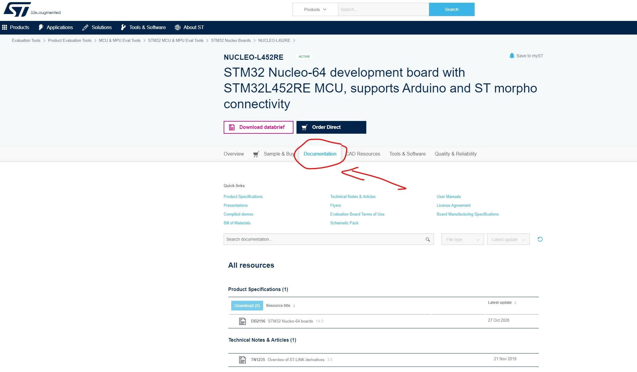

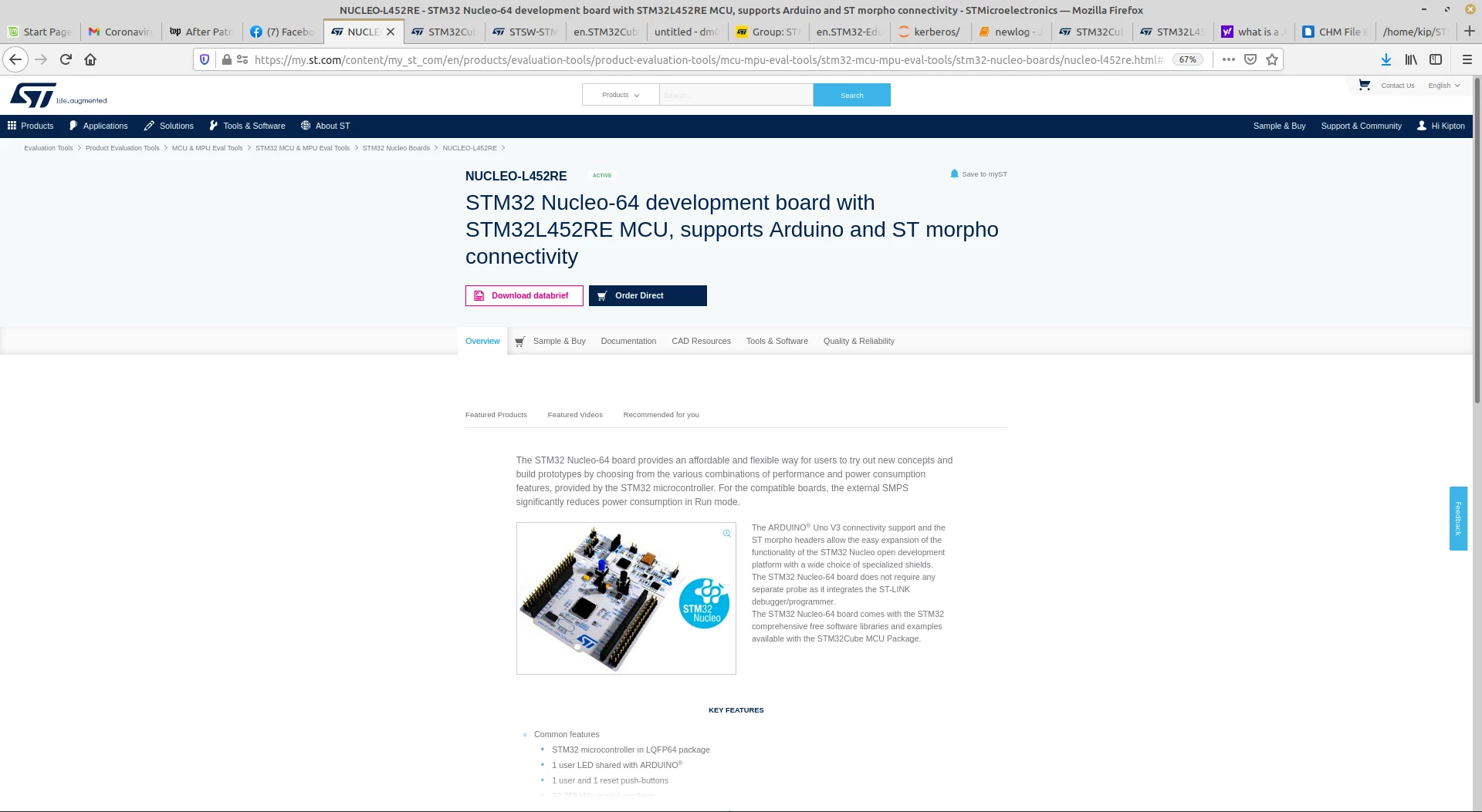

Jan 25, 2021 11:01 PM UTC
0693W000007CcUpQAK.pngI am trying to find the equivalent page to what you gave me. I searched the ST website for NUCLEO-L452RE there was this page that is not as helpful as yours looks for the other board.
What is the URL for the equivalent page for the NUCLEO-L452RE?

Cartu38 OpenDev
Graduate II
Jan 26, 2021 7:48 AM UTC
