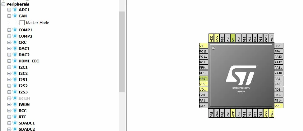

Does STM32F373 work in CAN Slave mode?
I am trying to implement CAN between two STM32F373, with one as master and another as slave. The problem I am facing is that it cannot be configured in slave mode. I am using Cube MX to create the initial configuration.
When I configure in slave mode CAN pins doesn't appear

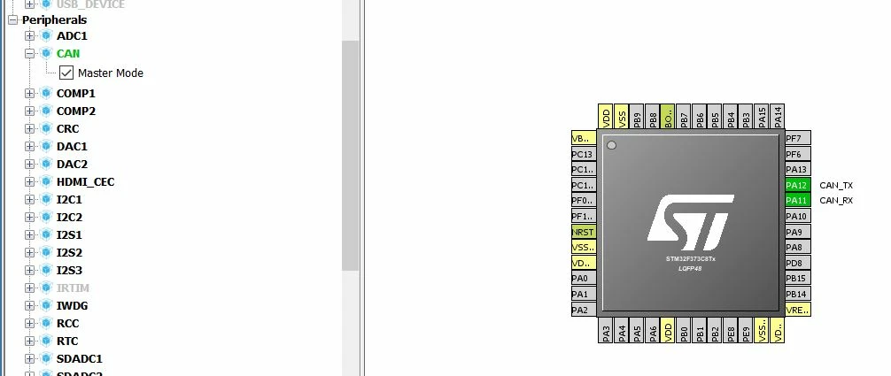

When I configure master mode the CAN pins appear as below
Code also doesn't contain CAN initialization routines, when Master mode is dis-selected. I have kept the generated main files as attachment.

If you want the cube to initialise the Can subsystems (HAL), then you have to tick the box.
Then its up to you, the Master/Slave aspects are user firmware defined..

Master and Slave mode of the bxCAN peripheral is only relevant if the chip has two CAN peripherals.
In that case they often share some of the required logic, and that means you cannot use the Slave CAN without the Master CAN.
Amel NASRI
Sep 27, 2018 4:20 PM UTC
Hi @debasish_deka​ ,
You need to select "Master mode" in order to enable the CAN peripheral.
I agree with you that this is confusing when the used device embeds only one CAN instance.
An enhancement request is logged internally to get rid of this confusion.
-Amel
debasish_deka
Oct 17, 2018 5:03 AM UTC
Thanks. The developer just needs to rename the Master checkbox by Enable checkbox
