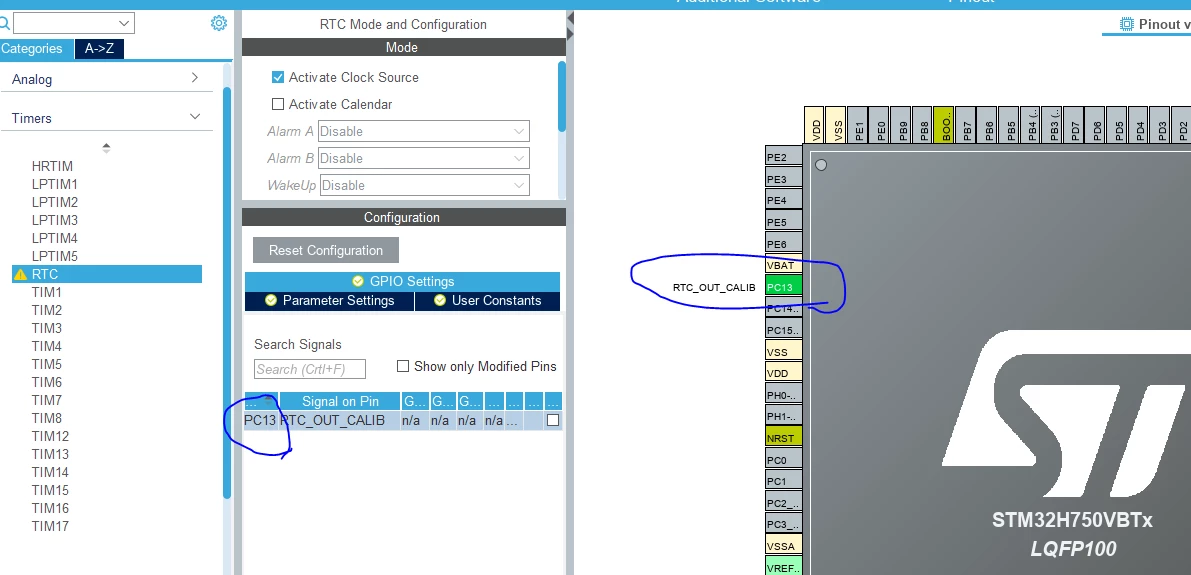

Does STM32CubeMX generate the wrong RTC_OUT Port Number on stm32H750VBT?
  • June 14, 2019
  • 5 replies
  • 2494 views

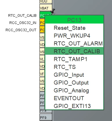

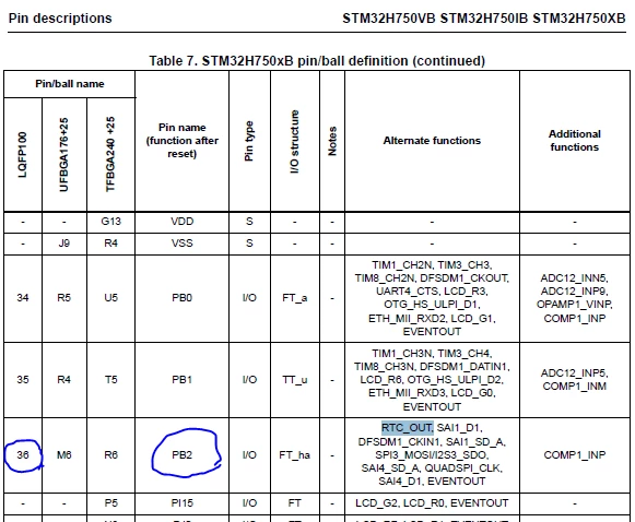

Does stm32cubeMX 5.2.1 has the correct pin_out for RTC_OUT signal for part STM32H750VBT6?
Here is from data-sheet say RTC_OUT is located PB2
and cubeMX say it on pin PC13 (winch other F series used to be):
5 replies

After verification, we confirm this issue and will be fixed in the next release.
Thanks and Best Regards,
Mohamed Aymen.
Mohamed Aymen HZAMI
February 24, 2020

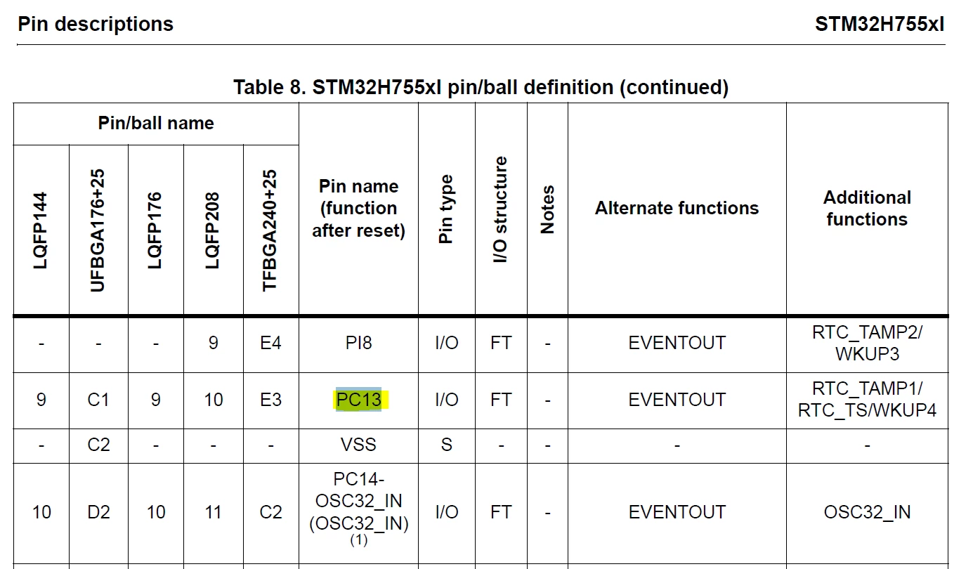

To be precise: STM32CubeMX is correct. The datasheet will be updated to add PC13 as RTC_OUT.
Best regards,
Mohamed Aymen.

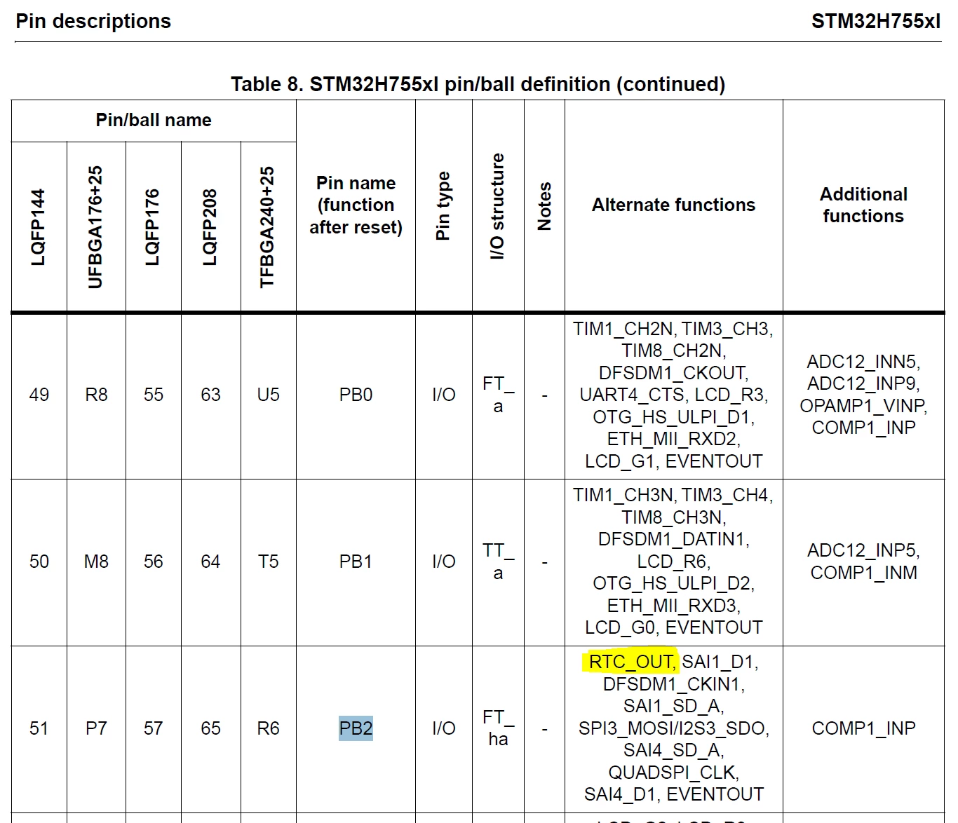

yilmazkircicek
September 3, 2024
Now 2024, September.
I have checked for the latest datasheet of STM32H745XIH6 and RTC_OUT is still shown in PB2.
Who should I trust, datasheet or CubeMx ?
Regards.

October 29, 2024
I am using STM32H755ZITx and RTC_OUT is still shown as PB2 only in datasheet (DS12919 Rev 2), Will there be any update ?
I tried enabled RTC_OUT_CALIB to PC13 and I got only 32kHz pulses instead of 1Hz pulse - In CubeMx selected "Calibration 1Hz"
Regards
