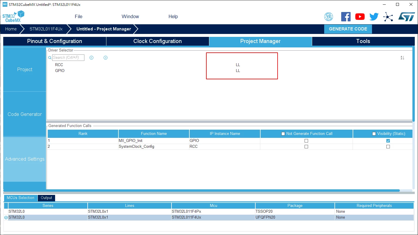

Does STM32CubeMX 5.3.0 supports LL code generation for STM32L0xx series? Thanks.
TDKBest answer
Oct 14, 2019 1:43 AM UTC
Did you click "Advanced Settings" on the left like I suggested? It works, I tried it. Make sure you have the latest STM32L0 package.
6 replies
Oct 13, 2019 8:30 PM UTC
Yes. Change from HAL to LL in the "Project Manager" -> "Advanced Settings" tab.

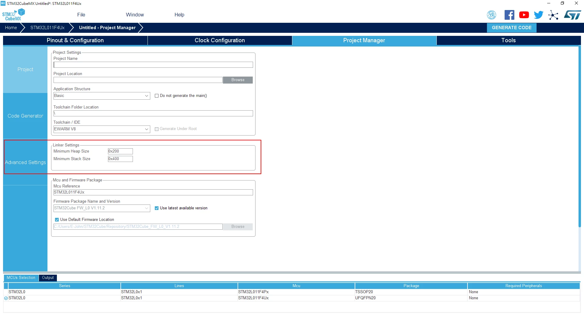

E-John
E-JohnAuthor
Oct 14, 2019 1:07 AM UTC
Hi TDK,
There is no option for switch "HAL/LL" on "Project Manager"->"Advanced Settings" tab of STM32CubeMX 5.3.0, see picture below
Is there any missing?
Thanks and Best regards,
E-John
Oct 14, 2019 1:37 AM UTC
On the left side, there are 3 tabs. You have the "Project" tab selected. Click on "Advanced Settings".
Yes, the UI is horrible.

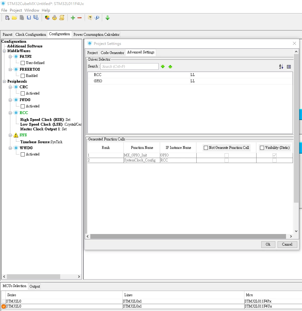

E-John
E-JohnAuthor
Oct 14, 2019 1:41 AM UTC
Hi TDK,
STM32CubeMX V4.27.0 is the last version I found that supports LL. see picture blow.
E-John

E-John
E-JohnAuthor
Oct 14, 2019 2:51 AM UTC
Hi TDK,
Yes, the different setting page appears after clicking the "Advanced Settings", like below.
