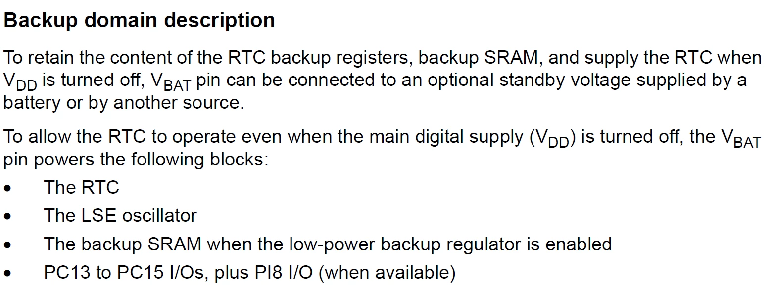

Does RTC backup reset when power is turned off?
RTC was set in Cube MX. (0y/0M/0d 0h:0m:0s)
A backup register is used to store the date and time.
For example, if you press the reset button at 0/0/0 0:1:1, RTC is activated from 1m 1s.
But when I turn off the power and turn on the power again, it goes back to 0/0/0 0:0:0.
And the backup register value is cleared.
I checked that HAL_RTCEx_BKUPWrite() is executed again.
I think it should work from the time the power is turned off.
Does RTC backup return to Cube MX settings when power is turned off?
Is the backup register value also deleted?

Backup registers are in SRAM and are erased when power is lost. VBAT supplies power to them, so the typical way to retain them is to attach a battery to VBAT to keep it powered when your main source of power is gone.
From the RM:
