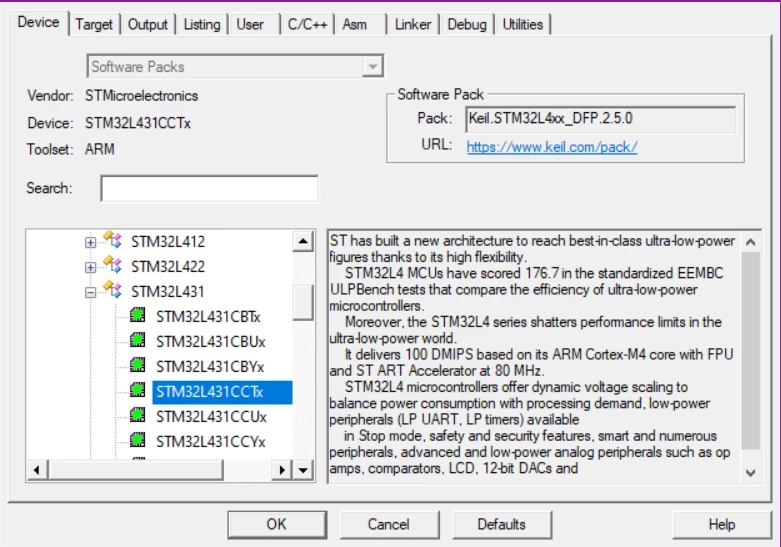

I previously made a project through STM32CubeMX based on the STM32L431CCT6 to generate the pinout and initialization template for Keil MDK-ARM IDE.
We are planning on transitioning to the STM32L431CBT6 (without any changes to the code), and I was wondering if I can just use the current project on Keil-MDK ARM to program the STM32L431CBT6 without generating a new STM32CubeMX template and Keil project, and copying all the files used in the previous project into the new one.
Are these are the steps below (performed on Keil MDK-ARM) sufficient to be able to port the project onto the new microcontroller:
  • Going to Options for Target -> Device and changing the device to the STM32L431CBTx

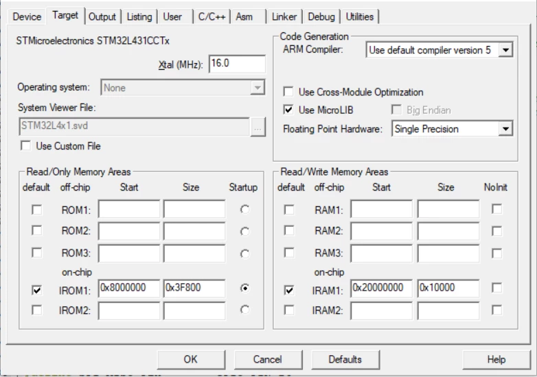

  • Going to Options for Target -> Target and change the Flash region since the size is smaller on the STM32L431CBT6, and verifying that the SRAM region is correct

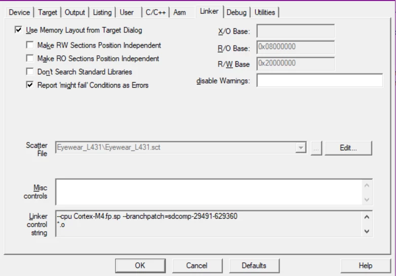

  • Verifying that the Linker is correct, which can be found under Options for Target -> Linker, and optionally, verifying that the scatter file generated is correct

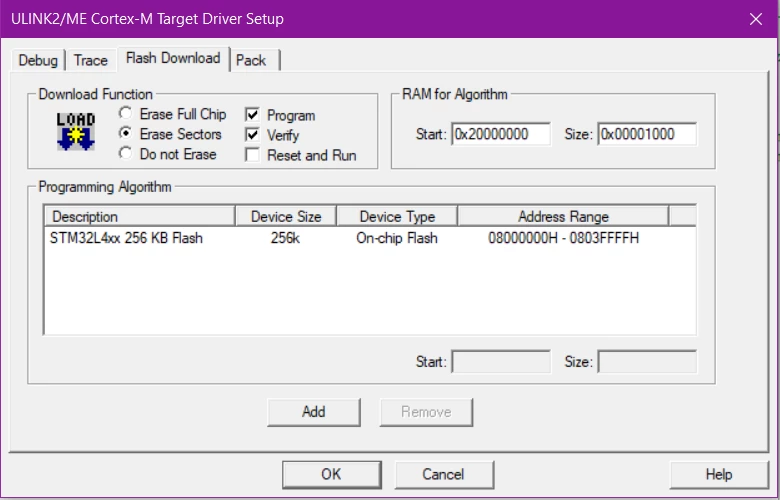

  • Verifying that the Flash region listed under Options for Target -> Debug -> Settings (button on the top right) -> Flash Download is correct, and that the 'RAM for Algorithm' section is correct
