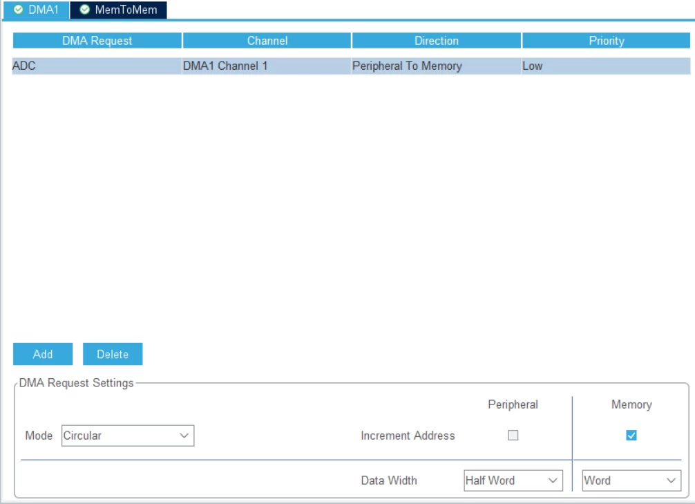

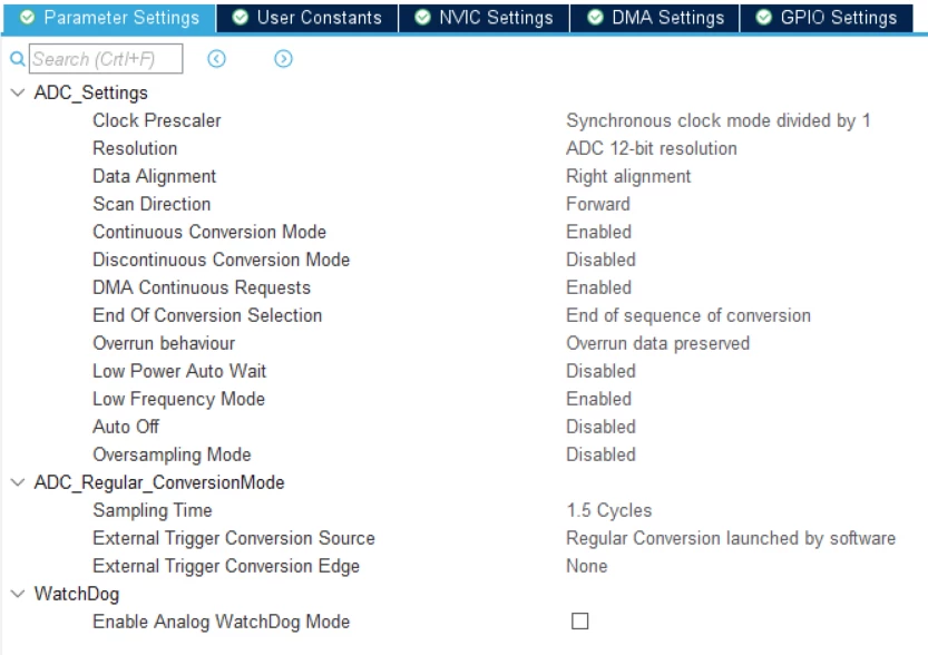

DMA registers are not set correctly on STM32L052K8T6 Hello, I want to use the DMA to shift data from 9 ADC Channels into an Array. The problem is that I set up the ADC and the DMA in CubeMX. But the Registers of the DMA are not set correctly.
My CubeMX Setup:
DMA:
0693W00000GXM5cQAH.pngADC:
0693W00000GXM5wQAH.pngADC NVIC:
0693W00000GXM6QQAX.pngAfter I had done this, I generated the
Code and Started the ADC and the DMA with the HAL_ADC_Start_DMA function. The
function Started the ADC as I wanted, but the Registers of the DMA are not set
Correctly.
The DMA register, which is not set correctly:
0693W00000GXM4aQAH.pngI assumed that the CIRC and the MINC bit should be set, and also the PSIZE should be 0x01 and MSIZE 0x02. Have I done something wrong or what is happening?
If you need some more Information, just say it and I will upload it as fast as possible.
Amel NASRI
Amel NASRIBest answer
Nov 16, 2021 3:38 PM UTC
Hi @Mathias Müller​ ,
Please check the order of the calls for HAL_ADC_Init() and HAL_DMA_Init().
In the generated code, make sure that HAL_DMA_Init() is called first, then HAL_ADC_Init().
-Amel

MMüll.5
MMüll.5Author
Nov 12, 2021 11:40 AM UTC
I looked in an older project where I used the DMA for something similar. And I compared both of them and found out that the registers I want to set are set in the ADC init, so I looked into that and found some differences. I will try to fix that and tell you later if it worked and what exactly was wrong.
Amel NASRI
-Amel
MMüll.5
MMüll.5Author
Nov 17, 2021 6:19 AM UTC
Hi @Amel NASRI​
Thank you for your help. That was what caused the Problem, the HAL_ADC_Init() was called first. :thumbs_up:
Can you explain to me why the HAL_DMA_Init must be called first and why the Cube MX does not do it like it is supposed to be?
It also would be useful to know how I can generate code from Cube MX and force it to initialize the DMA first because every time I generate code I need to switch the MX_DMA_Init and the MX_ADC_Init in which the HAL functions are called.
Thank you in advance.
Mathias
Amel NASRI
Nov 17, 2021 9:09 AM UTC
The peripheral initialization (HAL_ADC_Init() in your case) modifies a DMA register, which needs the DMA clock to be active. The clock is activated in the DMA initialization. That is why it is required to call HAL_DMA_Init then HAL_ADC_Init.
Unfortunately this was a regression introduced in STM32CubeMX 6.3.0. A fix is expected in next tool release.
A possible workaround is to force the order of functions calls. Please refer to the paragraph Ordering initialization function calls in the user manual UM1718 STM32CubeMX for STM32 configuration and initialization C code generation.
-Amel
