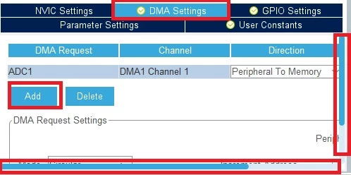

Cwoo.1
Oct 8, 2020 9:40 AM UTC
You can change the DMA data width in 'ioc' file or 'stm32f3xx_hal_msp.c' file.
In my case is use DMA for record ADC value. But now am i explain how change data width. So i think not many difference.
1.Change in .ioc file
I think maybe you aleady added DMA request .
After add DMA and click that request.
Then you got 'DMA Reques Setting' menu and 'scroll bar'.
Now you can change DMA working mode and data width.
2.Change 'stm32f3xx_hal_msp.c'
It maybe little diffrence because my DMAhandle name is 'hdma_adc1' and your DMAhandle name is maybe 'hdma_uartx?' anyway.
DMA init is occured in 'HAL_ADC_MspInit' function.
So if you change the data width of the code below, you can get the desired result.
  /* ADC1 DMA Init */
  /* ADC1 Init */
  hdma_adc1.Instance = DMA1_Channel1;
  hdma_adc1.Init.Direction = DMA_PERIPH_TO_MEMORY;
  hdma_adc1.Init.PeriphInc = DMA_PINC_DISABLE;
  hdma_adc1.Init.MemInc = DMA_MINC_ENABLE;
  hdma_adc1.Init.PeriphDataAlignment = DMA_PDATAALIGN_WORD; <--- here
  hdma_adc1.Init.MemDataAlignment = DMA_MDATAALIGN_WORD; <--- here
  hdma_adc1.Init.Mode = DMA_CIRCULAR;
  hdma_adc1.Init.Priority = DMA_PRIORITY_LOW;
I haven't actually tried the second method.
