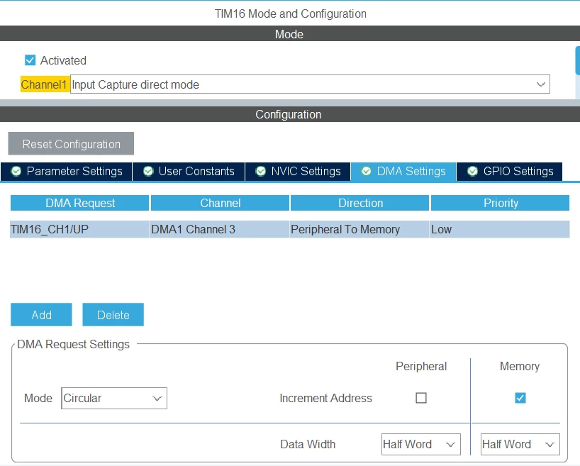

I have two Input Capture. One at channel 1 at TIM16 and one at channel 1 at TIM17.
But only TIM17 calls sevral times. TIM16 only calls one time. Then it seems that it stops.
Only call one time is a sign of the DMA is in normal mode. If I can call DMA servral times, that means that the DMA is in cirular mode.
What happens:
For input_capture0 (TIM17) array, it works like a charm. Every time I pulse 3.3v onto the input, I get a different value.
But for input capture1 (TIM16) array, the function compute_frequency always return 0.153186 and the value never changes any more. No matter how much I pulse 3.3v onto the input.
Can it be that even if I have selected cirular mode for TIM16...it's still normal mode?
Because if I have normal mode on DMA for TIM17, the the same behaviour occurs, with a different value of course.
The MCU is STM32F373VBTx and STM32CubeIDE 1.7.0

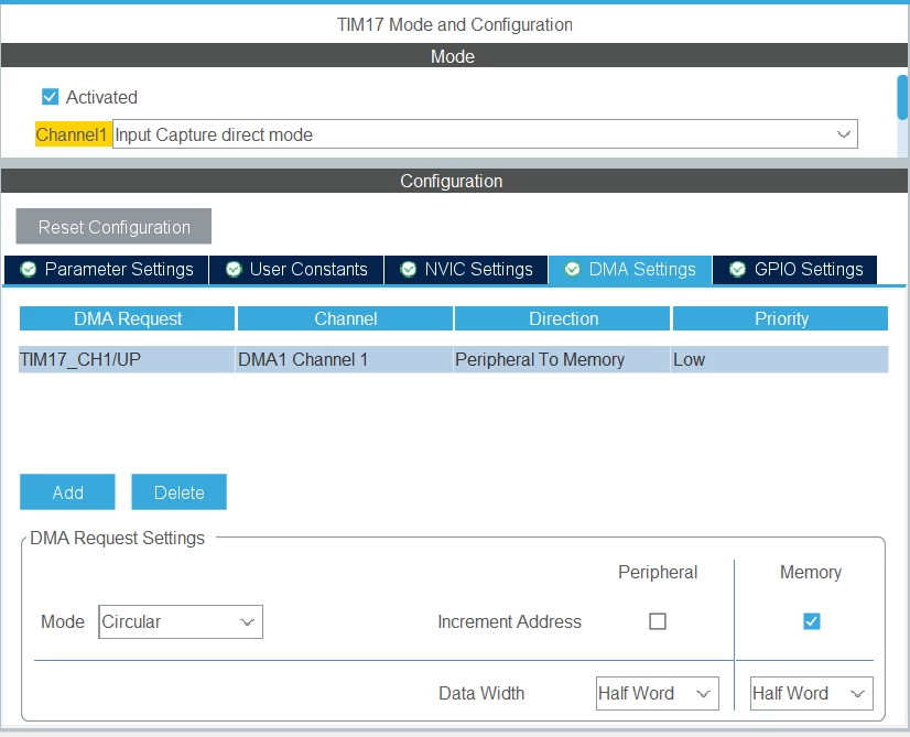

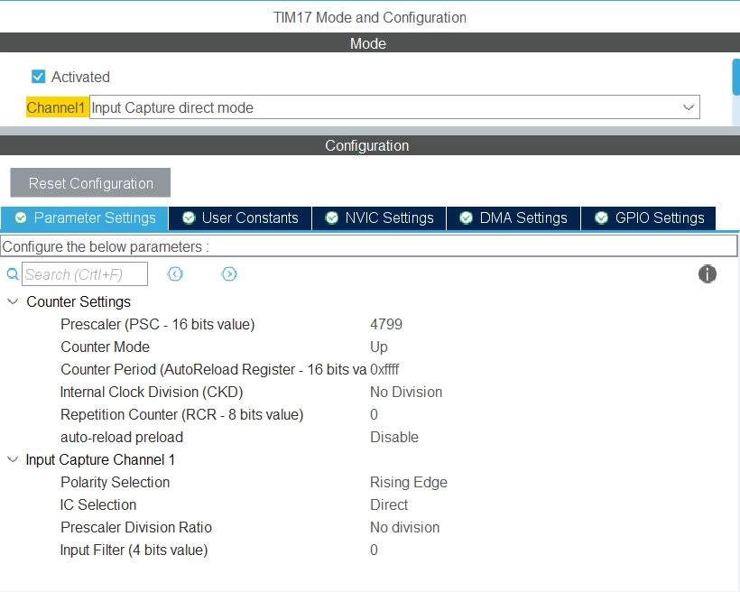

Here is my setup for TIM17.
0693W00000D1pJNQAZ.png0693W00000D1pJSQAZ.pngAnd here is for TIM16.

KnarfB
August 8, 2021
Have you checked the Cube generated code and the DMA register settings at runtime?
DMårtAuthor
Lead
August 8, 2021
I have generate the code bit I don't know where to look if at.​
