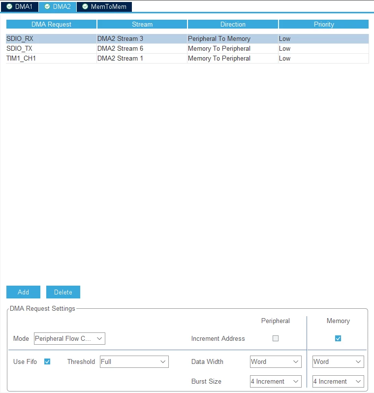

But why does SDIO DMA work then old version RAM settings are set? And the other way around TIM1 PWM DMA work when new RAM settings are set?
I think the issue must be with RAM. Maybe when new settings reduce IRAM1 from 0x20000 to 0x1C000 SDIO DMA has not enough RAM? How could I debug that?
My DMA settings in STM32CubeMX:
gbm
February 4, 2023
Check the memory usage and stack usage in the tabs of bottom-right pane of the CubeIDE window.
