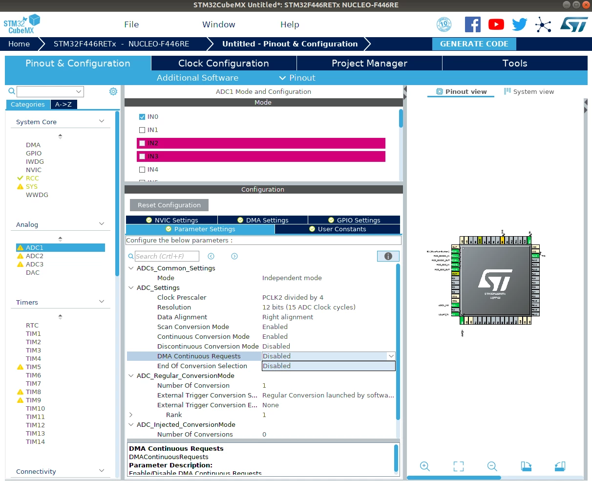

Hi!
I have a question. I know that the question is similar to https://community.st.com/s/question/0D50X0000APcm2T/stm32cubemx510-adc-dma-continuous-requests-doesnt-work
But I have heard that this bug was fixed in CubeMX 5.2.0. I'm using CubeMX 5.3.0 with Nucleo STM32F446RE board and this I want I get when I start a new project.
As you see, "Disable" is only selectable option here. Why?

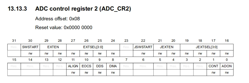

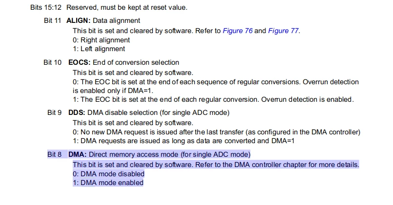

Have a look at this picture. DMA is available.

You need to add a DMA request for ADC on "DMA Settings" tab. After selecting a DMA stream, you'll be able to enable continuous DMA requests.
DMårtAuthor
Lead
September 23, 2019
Sorry. I have done that. Should I enable it manually in C-code?

Oh, sorry. I just tried with your model... Apparently this is an error with STM32F446 on CubeMX (works fine with my STM32F405VG).
If you want to enable manually, go to MX_ADC1_Init(void) function, and change "hadc1.Init.DMAContinuousRequests = DISABLE" to ENABLE and make sure your dma is configured in circular mode.
