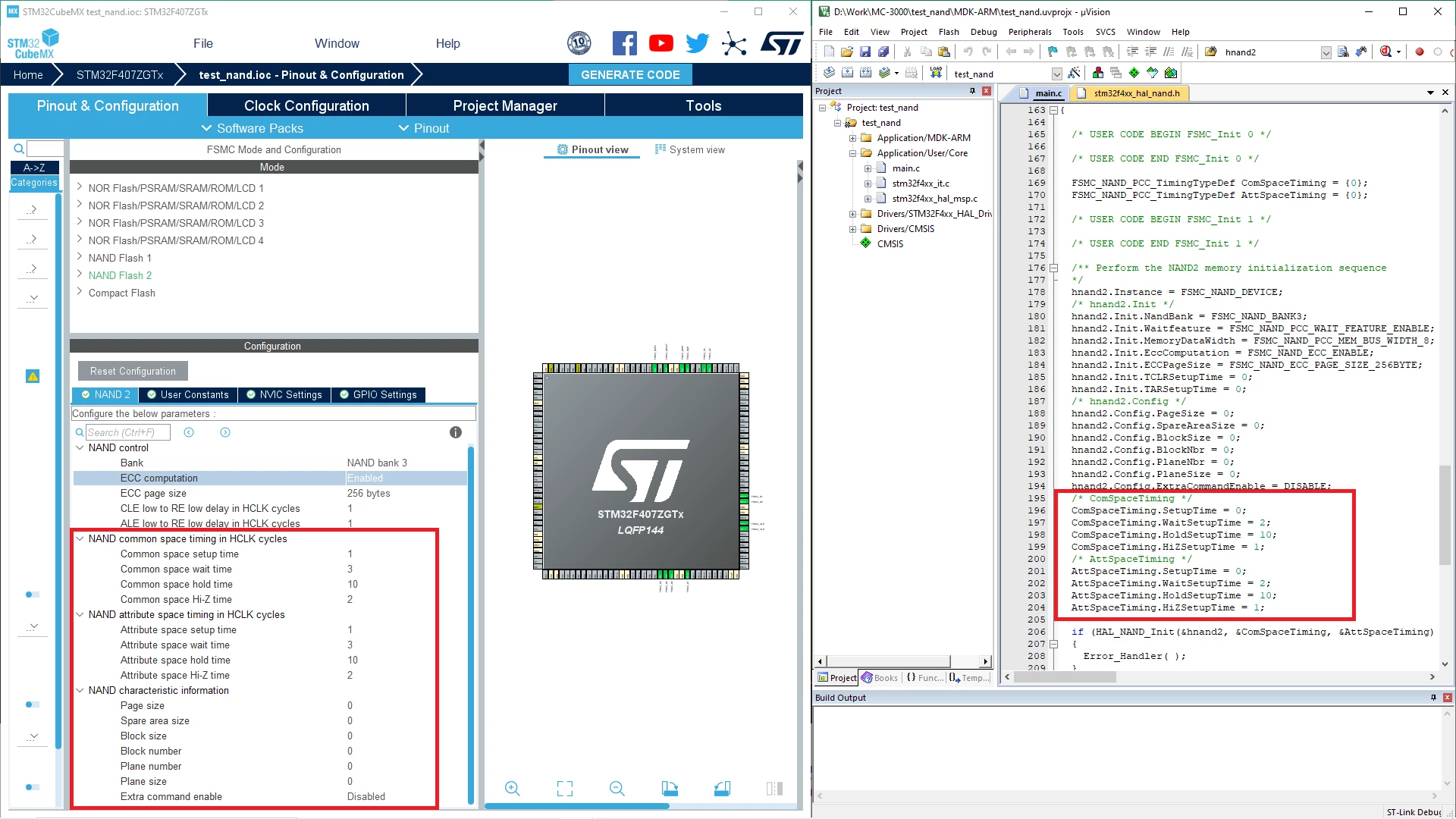

Distinguish setup CubeMx for Keil
Hello my friends, why is not generated setup from CubeMx for my Keil, why is distinguish setup ?12345678.png

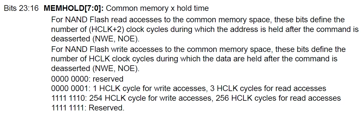

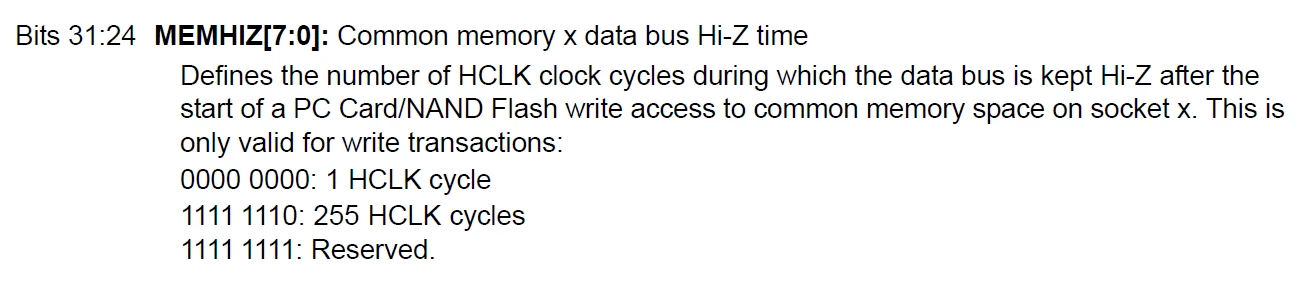

In the register fields that control these timings, a value of 0 means 1 HCLK cycle, hence the difference of 1.
Except for MEMHOLD which is the same:

Thanks a lot, this is user manual cubemx?
August 3, 2023
This is from a reference manual for the STM32F4 series.

First thing to check would be to see if HAL_NAND_Write_Page_8b is returning an error code.
Note that last parameter to this function is the number of PAGES to write, not the number of BYTES.
