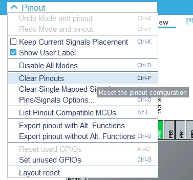

Another proposal when using STM32CubeMX with Board Selector: go to Pinout tab and click on "Clear Pinouts":
0693W000008wQbBQAU.png-Amel
