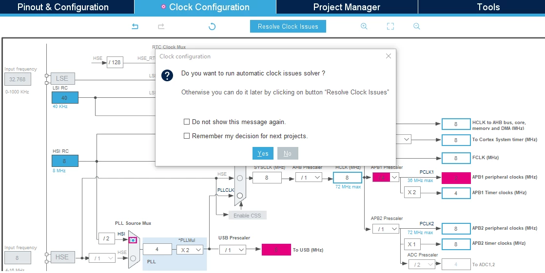

Hi there!
Is there a way to permanently disable the resolve clock issues feature of STM32CubeIDE-1.7.0? I've tried saying "No" and remember my options, but the interface just completely ignores me and does it anyway. It's utterly infuriating. Is there a preferences option somewhere I can set?
Is there a setting somewhere to disable this feature? It's frustrating as it keeps trashing my settings before I can fix them manually.
As it stands, it basically makes the .ioc view editor unusable. Since sometimes it just gets stuck updating clock frequencies even when you explicitly ask it not to, and it can very quickly ruin a configuration.

Same for me ! I couldn't reproduce your reported issue.
The only possible way to disable automatic clock issues solver is by clicking on "No" when this window pop up.
You can also check "Remember my decision for next projects" if you don't want CubeMX to solve your clock issues anymore.
If you don't have any other related questions, please make this one as "resolved".
Thank you for your contribution @etheory​  !
Mouadh.

Hello @etheory​
Thank you for your post.
Could you please share your ioc file with me ?

Hi @Mouadh JERIDI​ thank you for the response.
I just tried to reproduce the issue but am having difficulty doing so.
I will try a few more times over the next few days and send through a repro when I find one.
