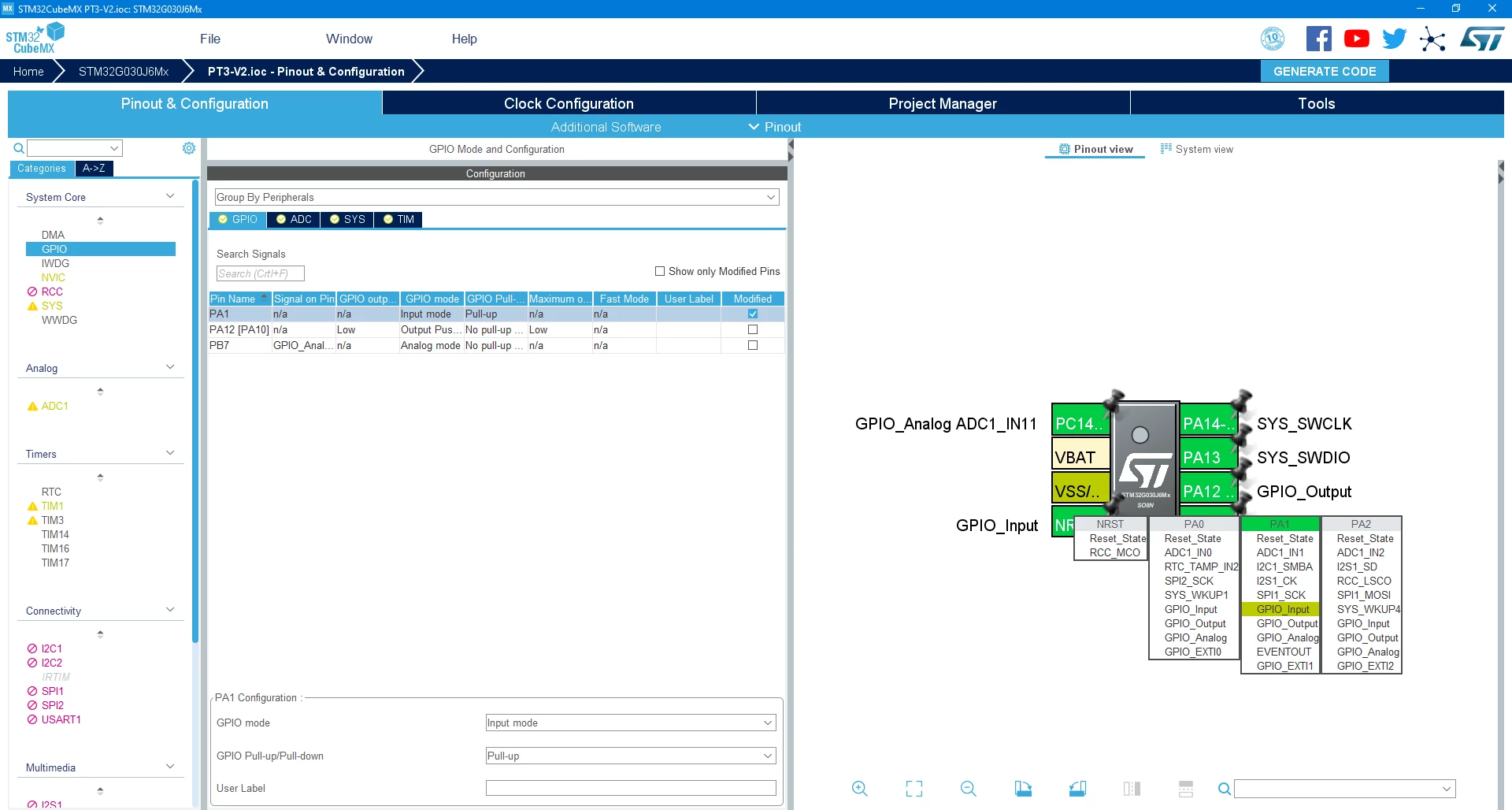

I have a design with a STM32G030J6 (SOIC8) controller. I don't need an external reset. I want to use the pin 4 as a GPIO (PA1). I connect a button to this input. I select the appropriate option in CubeMX, but when the button is clicked, the controller resets. How can I disable NRST from this pin?

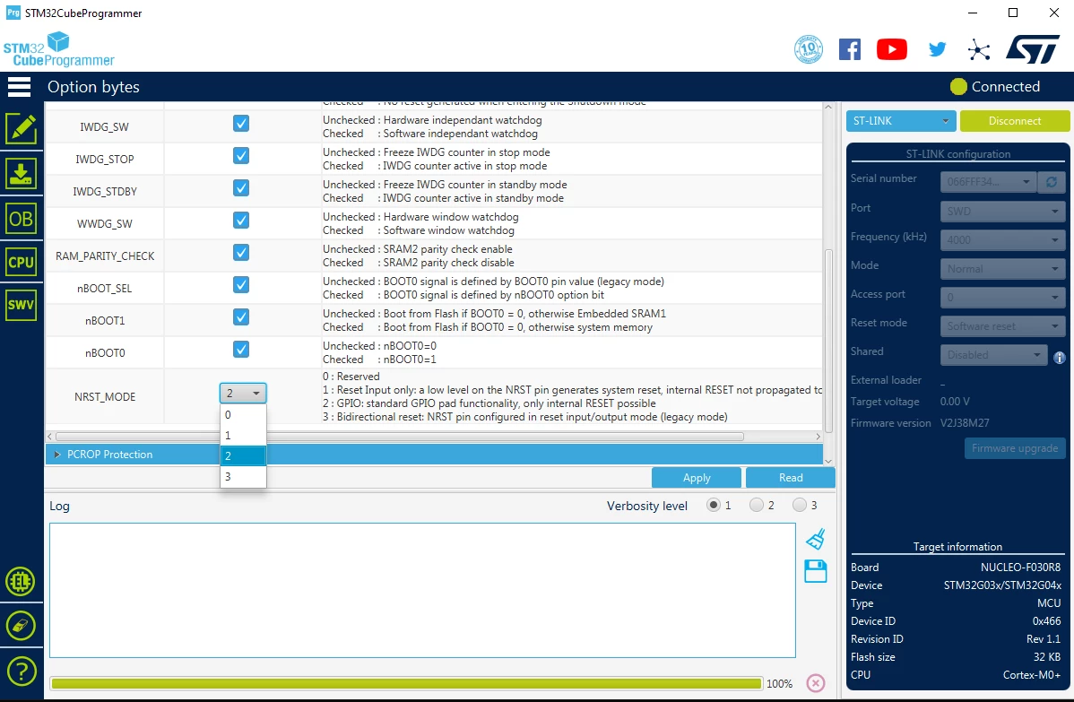

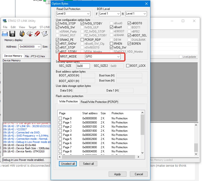

On the STM32CubeProgrammer you do it by selecting the option byte NRST_MODE and chose # 2 which is GPIO: standard GPIO functionality, only internal RESET possible0693W00000D1aJ3QAJ.png wji

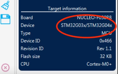

Looks like you're using STM32F030 whereas the OP is using STM32G030. They do not share the same option bytes.

You're mistaken.

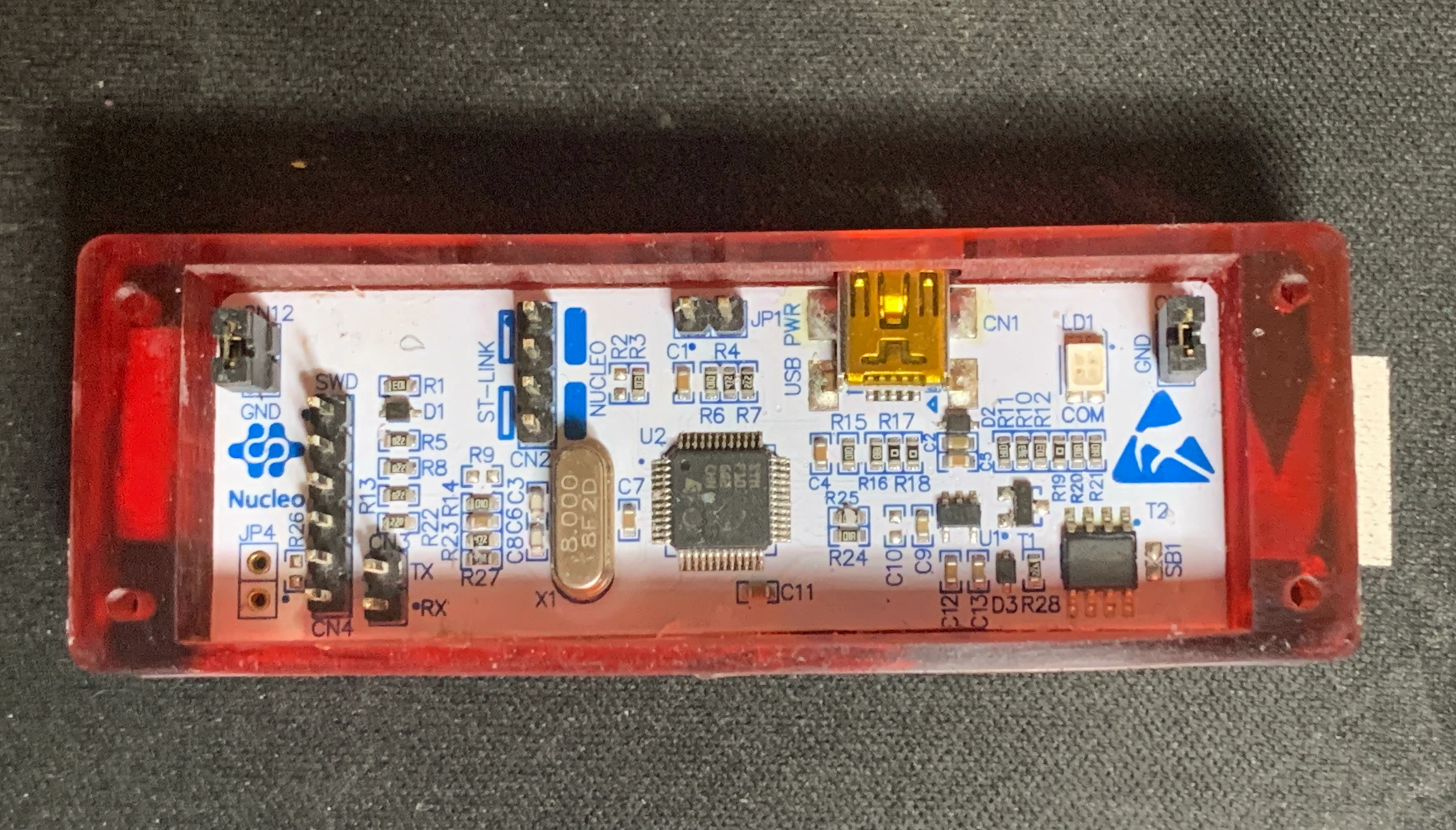

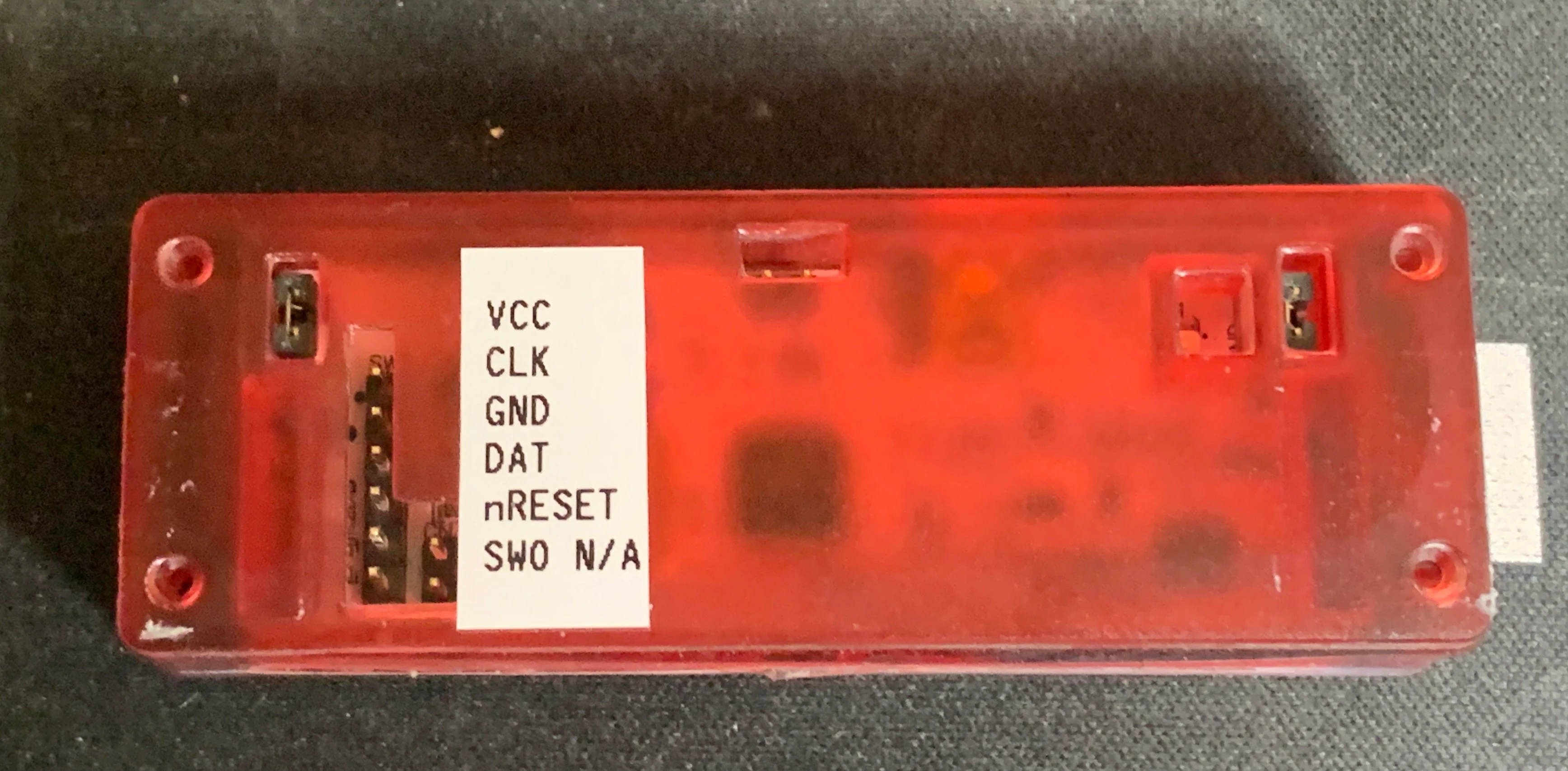

If you look at the screenshot that I posted in detail you will notice that the device is an STM32G03x series. What you see as a F030R4 "BOARD"is the identification of a nucleo STLINK section of that nucleo board. That line identifies the programmer not the target device. You can separate a nucleo STLINK programmer and make a standalone STLINK programmer with any nucleo that has one.
0693W00000D1asSQAR.png0693W00000D1ayuQAB.jpg​
0693W00000D1azTQAR.jpg​
