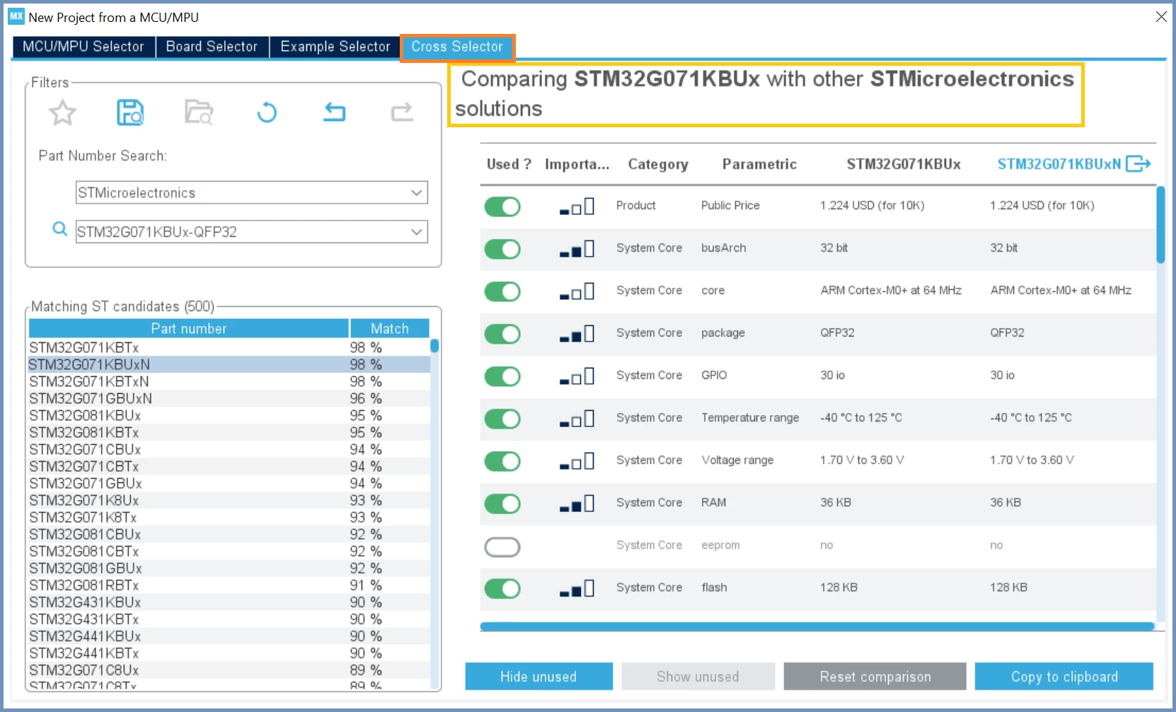

Difference between STM32G071KBTx and STM32G071KBTxN?
Have you ever seen the "N" suffix at the part number? Is the first time I see it. It seems to be some pinout differences, but... it implies any more differences?

In the datasheet: " other = 3-character ID incl. custom Flash code and packing information; x = N for PD product version"

As mentioned By @Uwe Bonnes​, STM32G071KBT6xyy with xyy = N option means the PD product version.
I would take this opportunity to present you the Cross Selector in CubeMX, it's an easy way to compare two or more Part Numbers:
