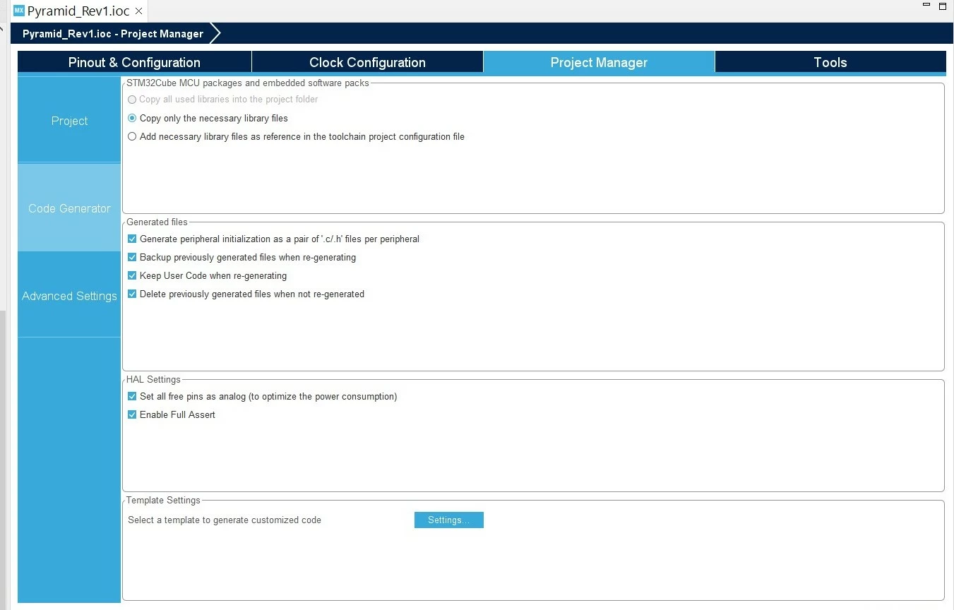

Device Configuration Tool does not generate the code.
I have been using STM32CubeIDE (Version: 1.10.1) with STM32CubeMX - STM32 Device Configuration Tool Version: 6.6.1-RC2.
But when i do some modification in device configuration and then try to generate the code , it does not generate the code. But when i create the new project using same device configuration file (project.ioc) it does generate the code with new changes , just popup appears for less than a second saying "device configuration Tool updating code .." and then just disappears without updating the code or any error.
What could be the problem?

Hello @KKato.2​ and welcome to the Community :smiling_face_with_smiling_eyes:
I would like to know is it the first time that this problem occurs ? was it working properly previously ?
Can you show me your code generator settings under Project Manager in CubeMX ?
Also, can you record the popup that appears ?
Sarra
KKato.2
KKato.2Author
Oct 27, 2022 12:35 PM UTC
Hello Sara,
Yes the problem occurred first time , not sure but probably when I installed update for STMCubeIDE.
It was working fine before.

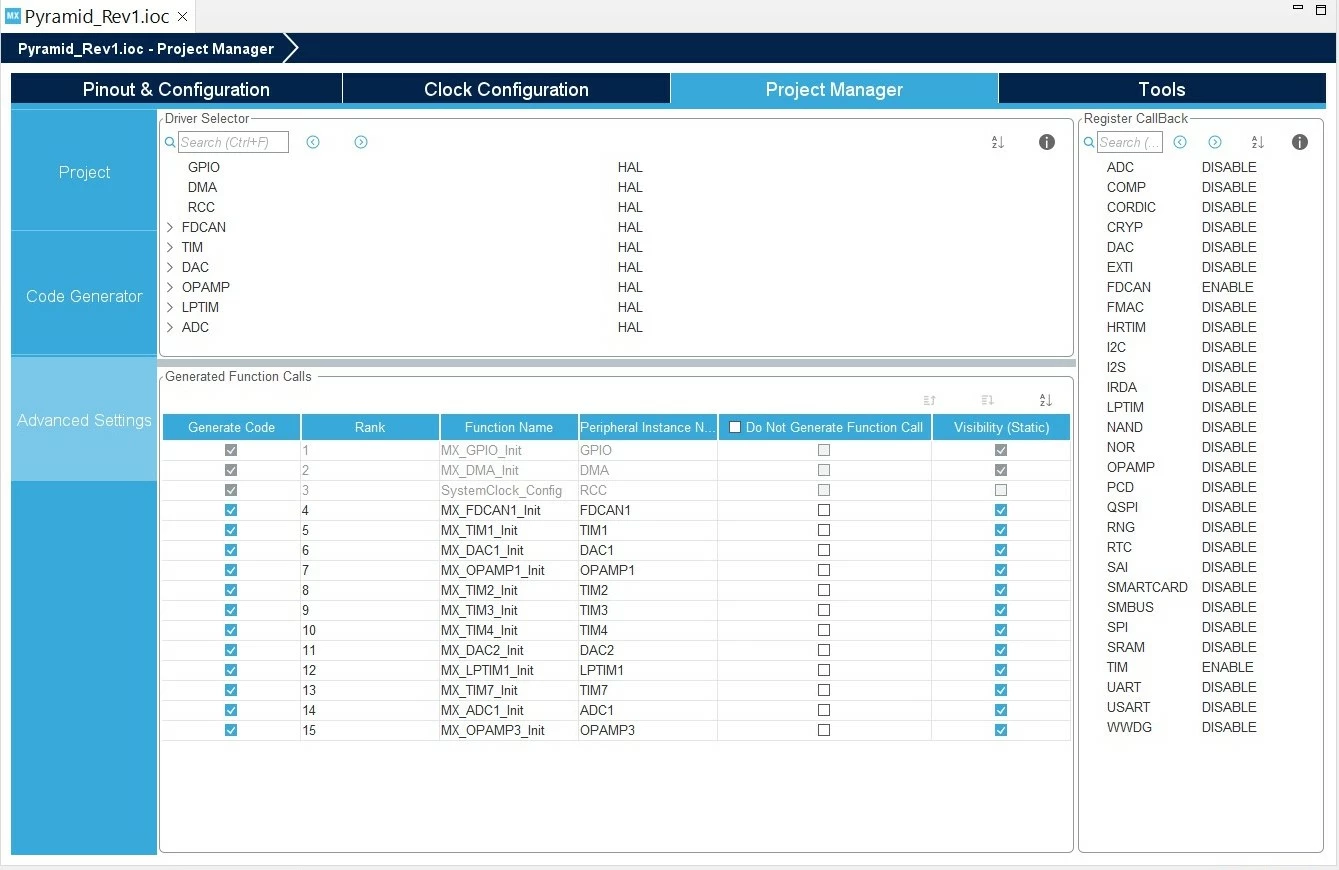

I am sending the screen shot for the code generator setting
I can't record the popup as it disappears withing a second.0693W00000VOGRZQA5.jpg0693W00000VOGRUQA5.jpg0693W00000VOGRPQA5.jpg

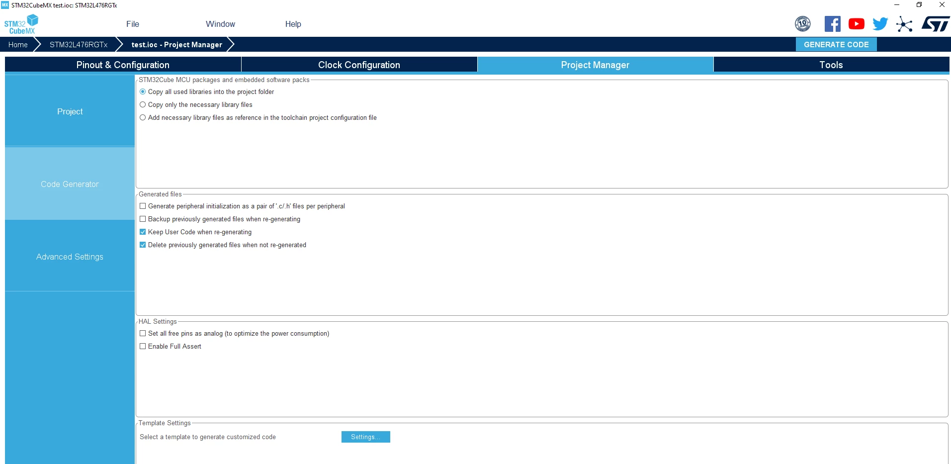

hello again @KKato.2​
I have the same version of CubeMX (6.6.1) and CubeIDE (1.10.1) and it works fine for me!
Try to change your settings as following :
0693W00000VOGo4QAH.pngif the problem persists, maybe try to work directly on STM32CubeIDE !
Sarra

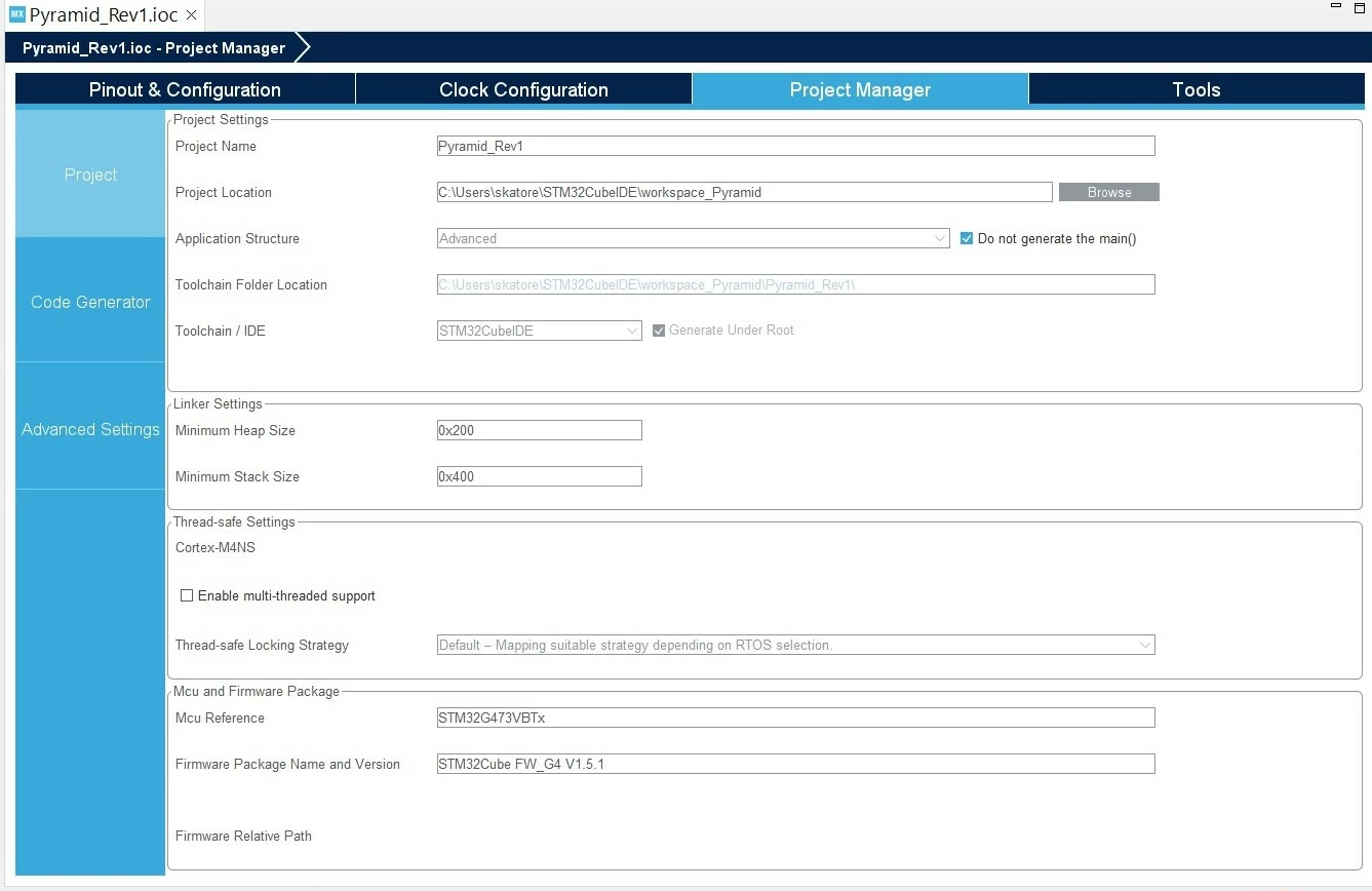

krishna
AScha.3
Oct 31, 2022 11:27 AM UTC
just i see: you checked -> NOT generate main.... better try: unchecked !
KKato.2
KKato.2Author
Oct 31, 2022 12:26 PM UTC
Tried that too, still not working.
